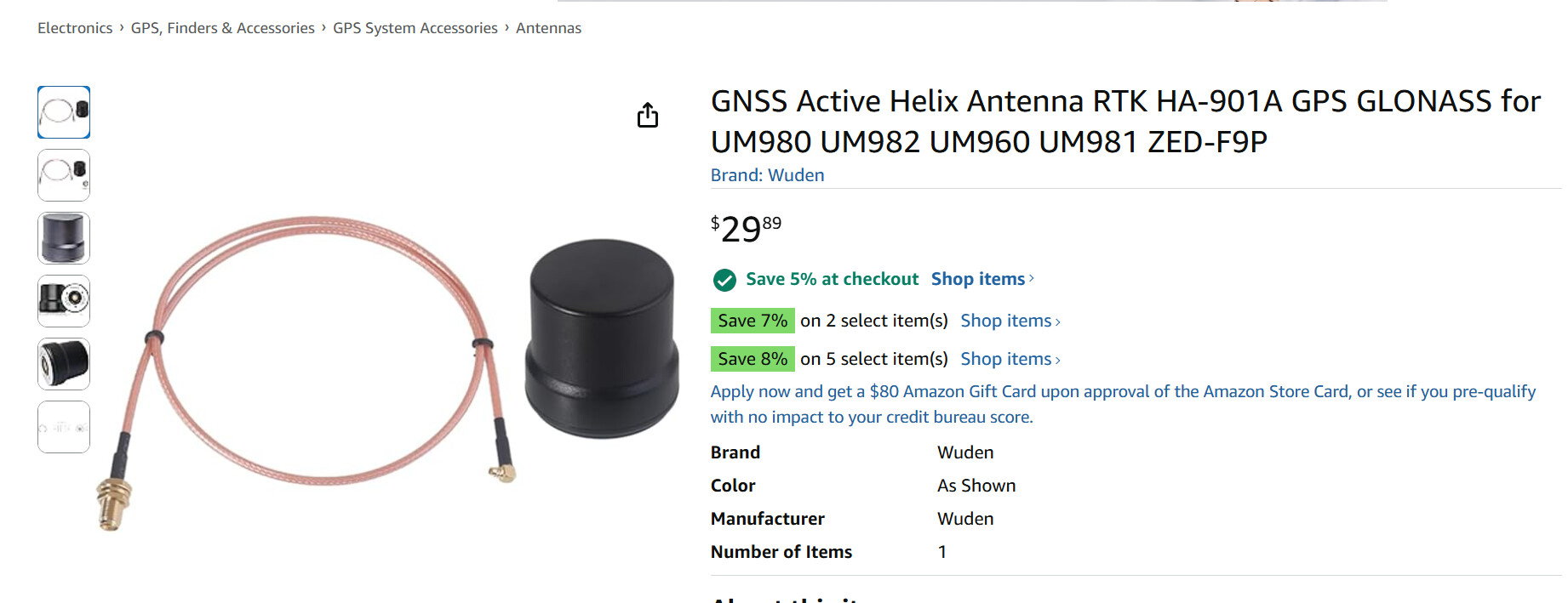

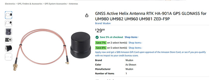

Look for GNSS HA-901A. It’s a slightly different part but does work well while you wait for factory replacements. Supposedly a slightly better gain, but… meh, not really. I swapped back to factories.
Note the connector on the included pigtail will not work on the core.
