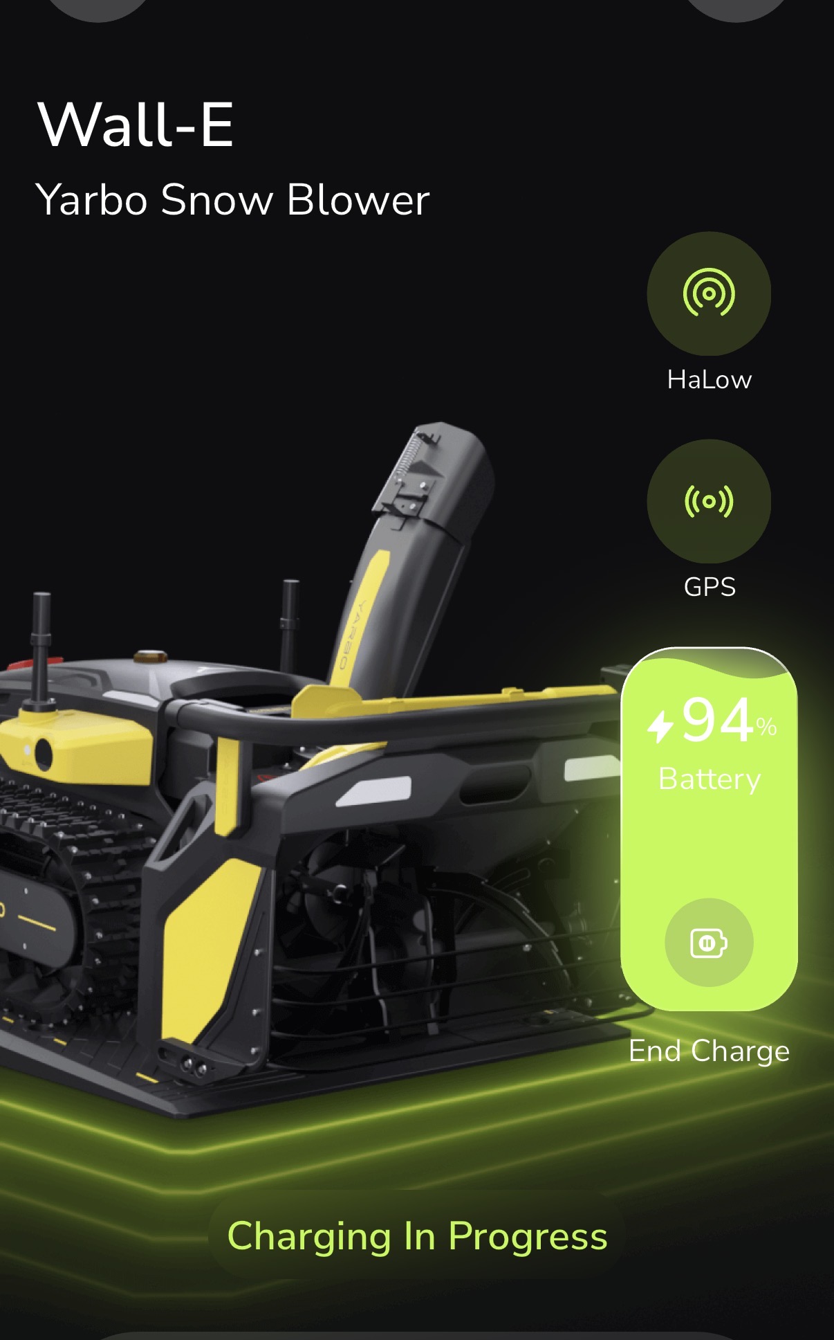

It looks like maybe my Yarbo is suffering from a BMS related issue.
For the past 2 days, the battery has refused to charge to over 94%.
I decided to wait until the next snow day to see what happens after the battery is discharged.
So today we got some snow, and now after recharging, the battery stopped at 94%.

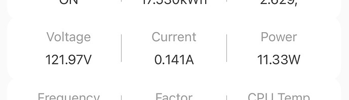

The app says it’s still charging, but my electricity monitor tells me the dock is idle and only drawing ~11 watts. Not actually charging.
This doesn’t seem as severe as what some others have reported, so I’m not sure if it’s the same issue or not.
