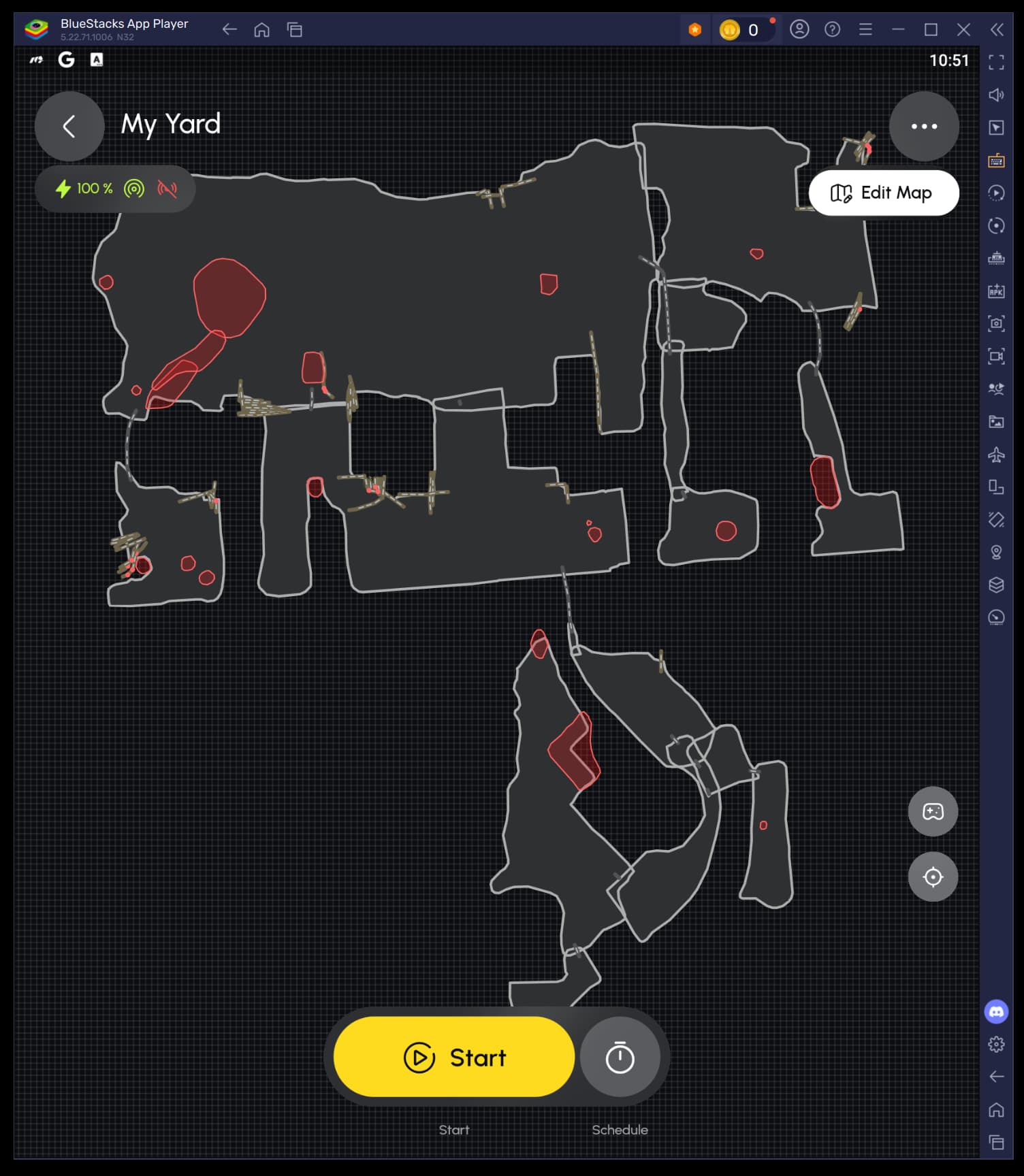

Great idea! BlueStacks works perfectly to keep an eye on things from work during cutting.

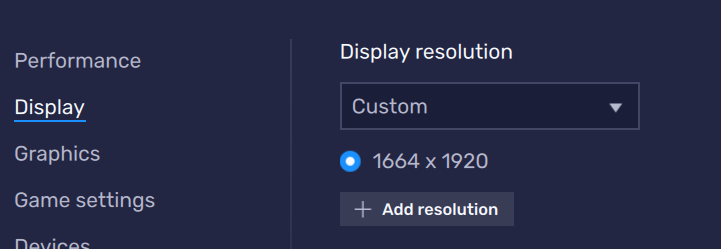

Remember that in Bluestacks, you can get into settings and make a custom sized tablet.
Head to Display, “Add resolution”. Be sure to make your window taller than it is wider, so that landscape/portrait work properly. In my case, I set my width to 1664 and height to 1920.
Once created, you can select it. Enjoy seeing the entire map!

Very useful - thanks for that! You can now take a single snapshot of the Diagnostics without scrolling – all in one place now.
