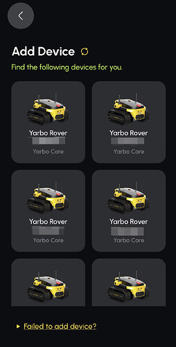

  5. Select Your Yarbo Device: Select your Yarbo from the list. If it doesn’t appear immediately, tap “Refresh” icon and check again. If you’re unsure of your Yarbo’s SN code, simply open the power cover and check the number on the Bar code inside.
  6. Connection Successful: Congratulations! Your Yarbo is now connected to the Yarbo App. You’re ready to enjoy a fully automated and intelligent snow-clearing experience.
