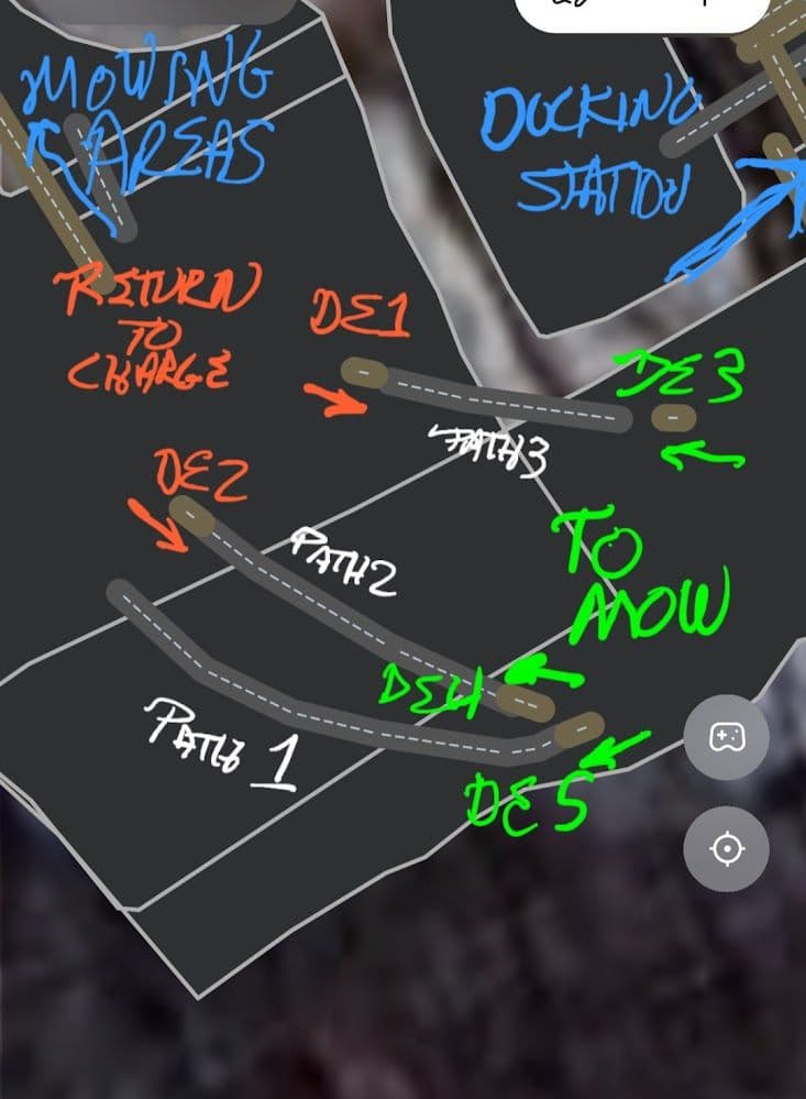

  1. Create a couple of redundant Pathways that go to/from the same Areas.
  2. At the ends of each Pathway, create a short Deadend that starts a tiny bit off the Pathway and ends on the Pathway. To do so:
    – Look at your map, drive the rover to an endpoint of Pathway but not quite on it.
    – Create Deadend. Start the Deadend just a very short distance from the Pathway’s endpoint on the map (probably a foot or two in real life), and aim the rover directly onto the Pathway, straight
    – Drive the rover forward following the Pathway until you see the Next button light up. Your Deadend will be a very short couple of feet.
    – Save the Deadend (I left the mowing height and speed at the defaults…yes, the blades will come on when mowing)
(All this exactness may not be needed, but it works, it is easy to comprehend, it looks neat, and if you keep things straight it minimizes impact on the grass.)

What happens? The rover heads to the first item in the Work Plan, the Deadend at the endpoint of a Pathway. The rover mows that tiny stub of a Deadend, and then continues straight along the Pathway it’s next to.
Wut? Yeah, I was surprised – the rover FOUGHT ME with everything else I tried and always took Path 3 in the picture. EVERY TIME. I was able to change the behavior this time using stubby Deadends.
So what about when the rover comes back to charge? If you do nothing, I’ve seen it take that Pathway it took out – it must be how Yarbo’s navigation works. If you want it to take a different Pathway, do the same thing, only from the other end (DE1, DE2), adding those Deadends to the end of the Work Plan.
So…how do you actually vary this? It’s all in the Work Plans. You can create multiple Work Plans for the same Area and vary the stubby Deadends you put onto those Work Plans, then Schedule them on different days. Or, if you’re like me, you have a few Areas you mow separately that are beyond those Pathways. Using this technique, each Work Plan can have its own navigation path, defined by you and your stubby Deadends and multiple Pathways.
Example picture:
  • The docking station is way on the right
  • There are several Mowing Areas heading off to the top left
  • The rover comes toward DE3/4/5 to get to those Mowing Areas
  • The Work Plan for MowingAreaX lists DE5 as the first thing
  • The middle of the Work Plan is the same as before
  • DE2 is then added as the last thing on the Work Plan
The rover heads out to MowingAreaX, “mows” DE5, continues along Path1 and goes and mows MowingAreaX. On return, the rover “mows” DE2, uses Path2, heads back to recharge.
Another Work Plan is created for MowingAreaY which is beyond MowingAreaX. That Work Plan now has DE4 to head out, DE1 to head back to charge.
And so on.
To keep it simpler, if you don’t do a “return” Deadend, I believe it takes the same Pathway that it took before to head out, so you may not even want to bother with the “return” Deadends (DE1, DE2), just have different Work Plans select different Deadends heading out (DE3/4/5).
And, yeah DE3 is one of my first tries and a bit off the Pathway. I think it still works.
Align these stubby Deadends and Pathways with where your rover’s coming from to limit turns and the impact on the grass. Keep 'em straight so there are no turns needed to get to the start of the Deadends, and keep your Deadend aimed straight onto the Pathways.
