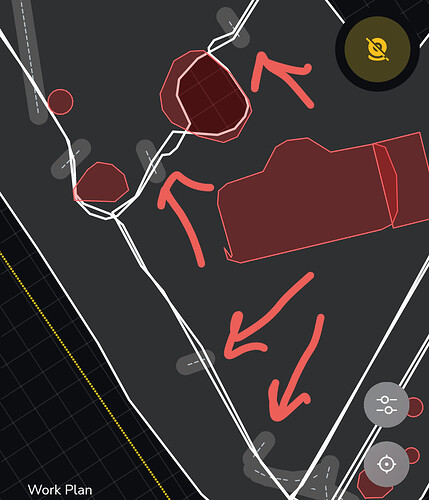

Weird pathway "dancing"/behavoir
Why would it do a, dance and then a bunch of tank turns and then go backwards through this pathway to get from one area to the next? Is it because of the overlap of areas?
Why can’t it just transition between overlapped areas even without a pathway? Or be able to mark overlapped areas as allowed to consider them a contiguous crossing zones?

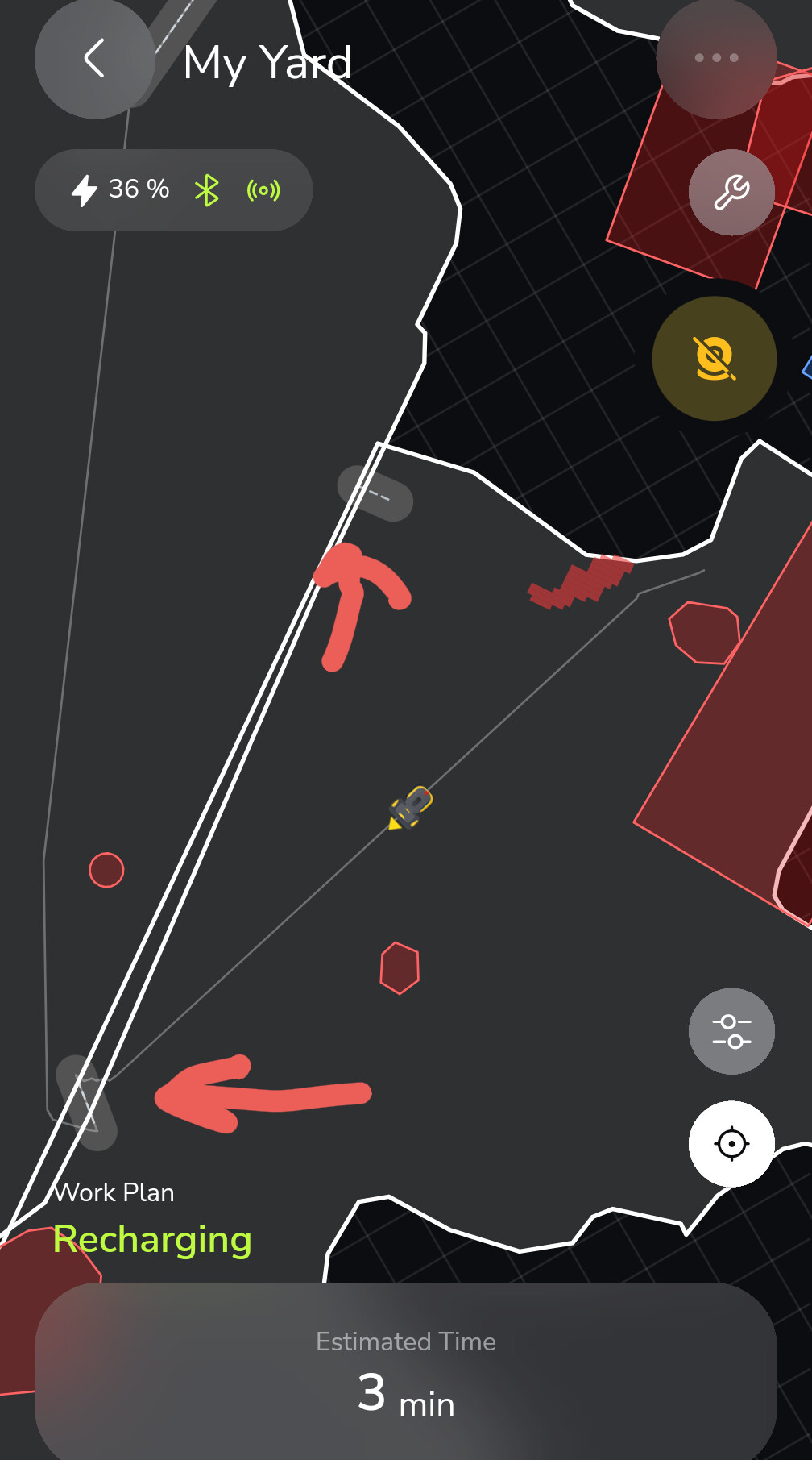

There are a few places I prefer it go to a specific area to cross to get better GPS quality first but I definitely don’t want missed swipes.
Would making that pathway longer help? I also need to re-optimize my dock pathways…
