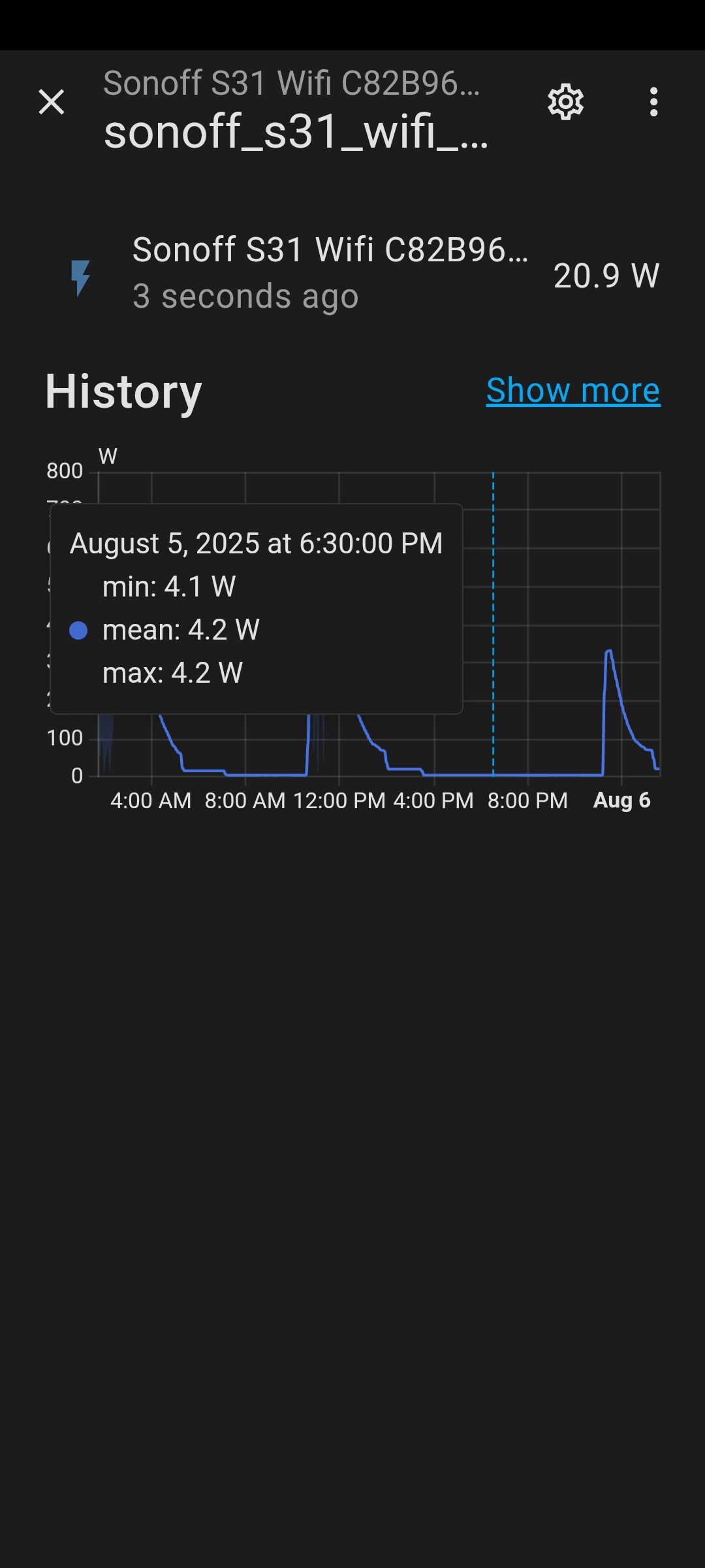

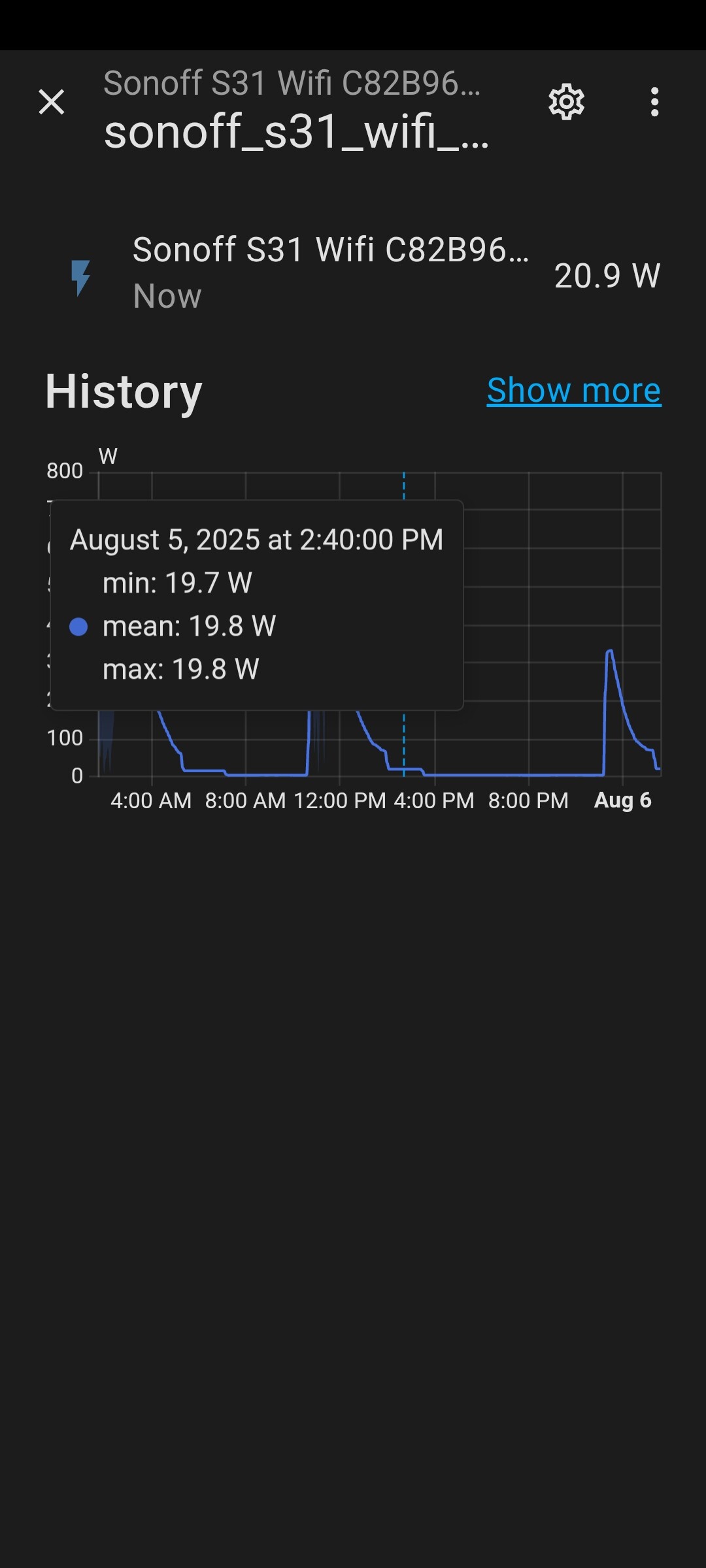

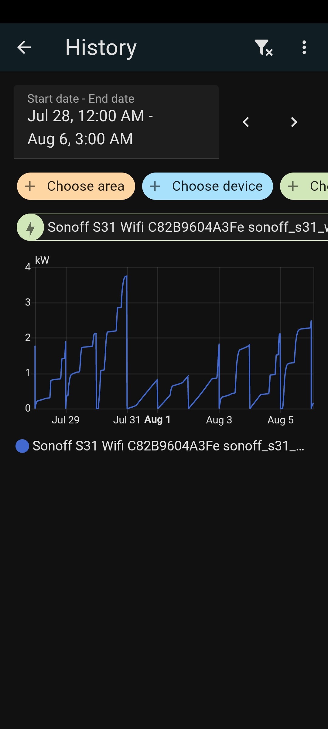

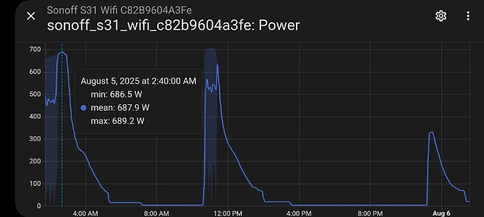

Not that I have solar. But I do have some power measurements that I’m sure some one could benefit from.
Note this is a 2023 core with a 2024 charger.
Charger seems to draw ~4 watts when the core is not docked. 20watts when docked and “fully charged” though I saw the battery drain when in this state so the core seems to draw more than what’s being provided in this state. And when charging it peaks to 700 watts. I also included daily power draw. Seems to avg around 2kw / day.
