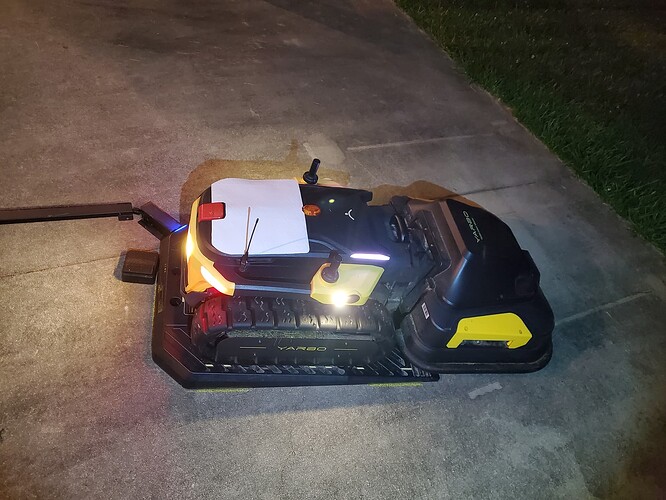

I’m going to try this to lower battery temps. A piece of 20 mil white vapor barrier attached with Command strips. We’ll see if it helps…and stays put.
Creative! I wonder if it would be worth covering the rest of the top?

yea, probably the more the better.
