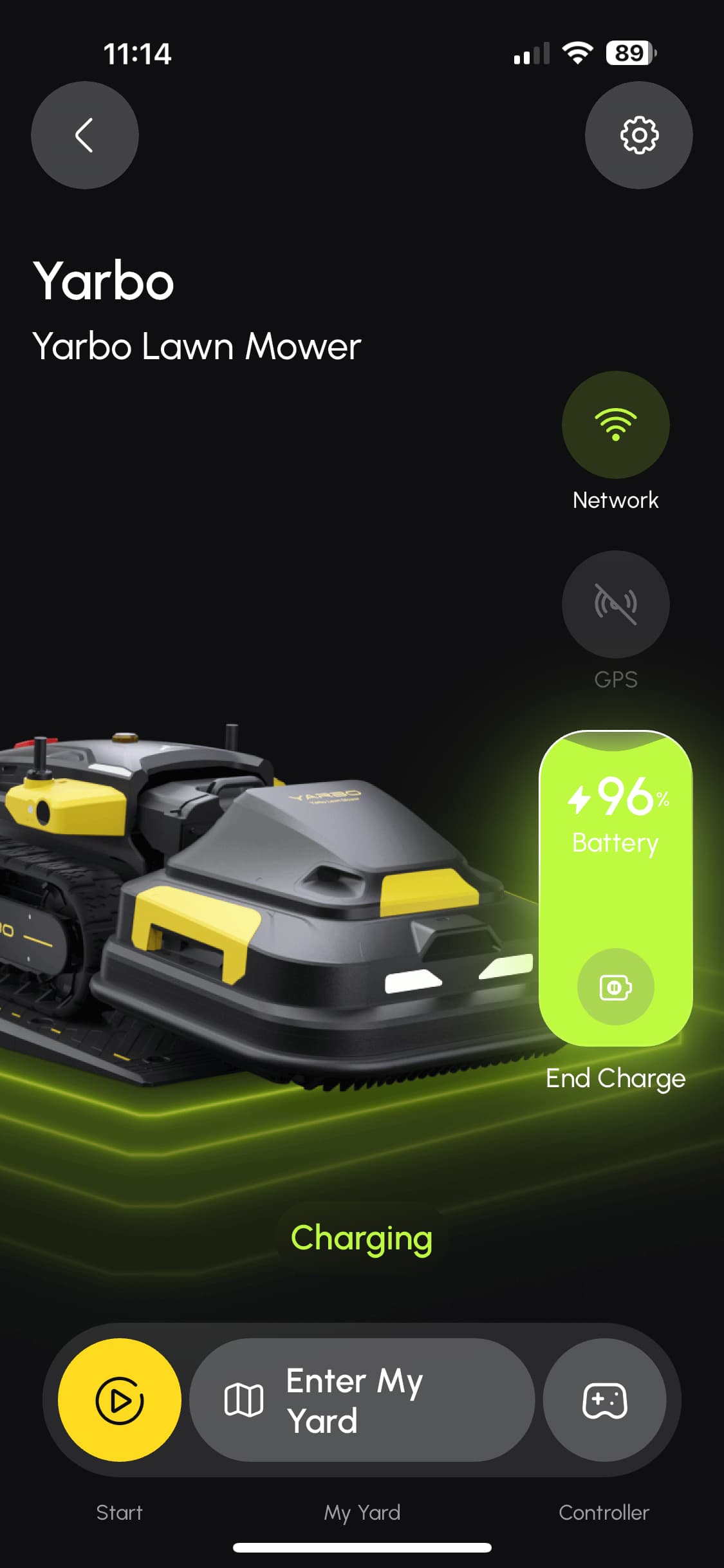

Yarbo has been on the charger for almost 24 hours. (That’s rare) and the app says it’s charging and at 96%.
I doubt it’s charging, but ready to charge if the battery falls out of the BMS comfort zone.

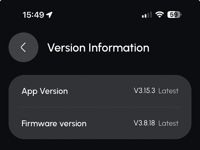

@jasonrusso @ken.w.gregory check and make sure you didn’t get the new firmware 3.9.10+ pushed. This could also explain the charging. It doesn’t always resume charging after a firmware update (usually hot fixes it will). If it doesn’t, it auto starts charging again around 90%.
No update.

I’ll send Yarbo to charge and give him a rest and see if I can get the update.
I got the update a few days ago. When that happens the app doesn’t say it’s charging.
