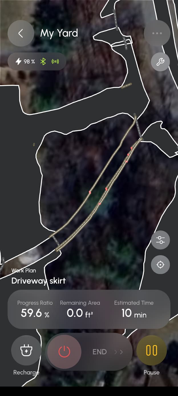

I have a ~50’ section of driveway that has maybe 2-3’ of grass on either side of it (and woodland beyond out that). And both sides are connected to lawn areas on both ends. What’s the best way to map this? I’ve tried a couple dead ends on either side of the driveway, and that’s an inefficient mess. You can see on the screenshot that the rover returned via the lawn area, instead of the dead end. (oh, and the little red dots are from shadows, I’m guessing, from when I mapped the DE’s). One of the others wen back and forth the same dead end 3 times.

Those red splotches are possibly track slippage. They should disappear with each run and only reappear if it slips again. You can watch it run in the app and a status message should pop up and say Yarbo is trying to get unstuck and then it will add the red splotch. Or it will say something like Yarbo is avoiding an obstacle if it detects obstructions with the camera or bumper. Bumper will generate a collision warning.

The blotches and jerky lines happened right after I mapped it. It’s flat and straight. But it’s partial shady area, so I think the vision system thought it was an obstacle.
