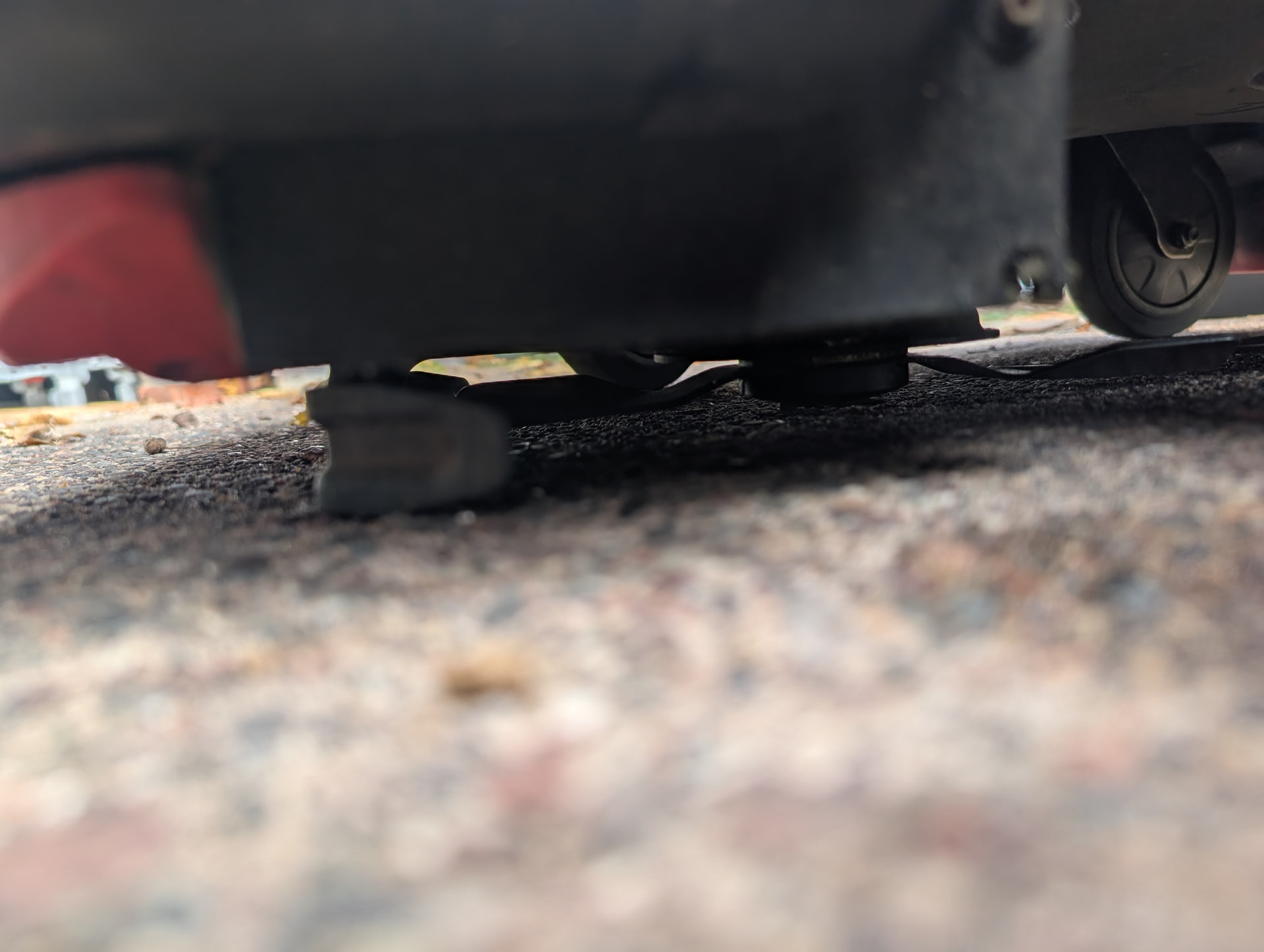

Ugg, this almost had me landscaping again​:sweat_smile::sweat_smile::sweat_smile:, was using smart vision to drive up front to do some maintenance(still missing waypoint mode with mower, wink wink) and unexpectedly got stuck crossing into the front yard through the gravel section…backed up gave it another go, tried to back up further and got stuck again trying to go further backwards over the “flush edging” and then it dawned on me the blades were probably low again!:man_facepalming::man_facepalming::man_facepalming:, yup…raised them and drove on no problem until one of the kiddos thought it would be fun to hit the estop​:sweat_smile::zany_face::joy:…(also excited for 2 way talk wink wink​:winking_face_with_tongue::grin:)
Please undo this feature or make it optional and/or auto raise once you leave the dock…maybe at least to the 2.7” “safe height”:+1::+1::+1:

Darn you can’t…and you were right it lowers way down and catches on the edging even though the path is set to the max ~2”(which would work…)…works at 0 passes for now though, maybe if the snow pack builds up it’ll work alright
After reconfirming with the team, the disc lowering logic has been updated. Previously, Yarbo would lower the discs fully after docking to make it easier for users to clean the area. However, since most users don’t perform cleaning immediately after docking, we adjusted the behavior to strike a better balance between safety and convenience. Now, the discs lower to approximately 2.4 inches (mid-position) instead of going all the way down.
