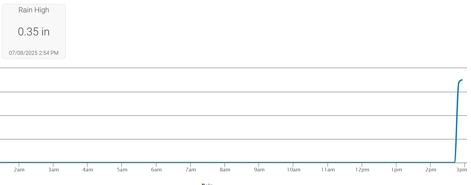

We got a fairly heavy rain .35 inches in 15 minutes. Yarbo was sitting in the blowing rain on the dock.
Right at the end of the downpour.
15 minutes after the rain had ended…

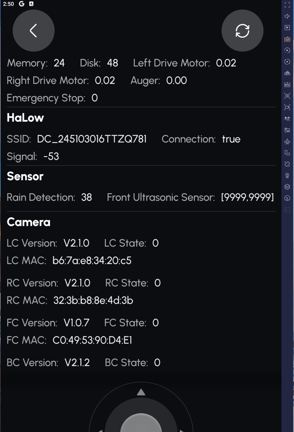

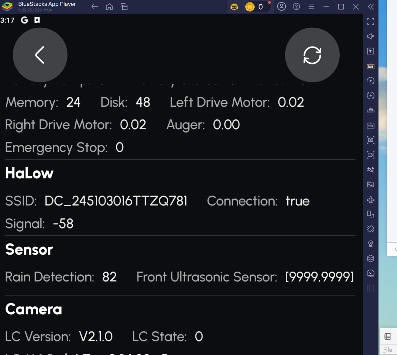

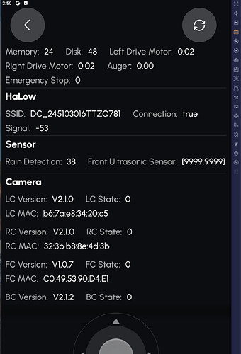

So sensor was reading 3 before rain
During the rain was reading 5-6
Minutes after the rain ended it was reading 38
15 minutes after the rain ended reading 82

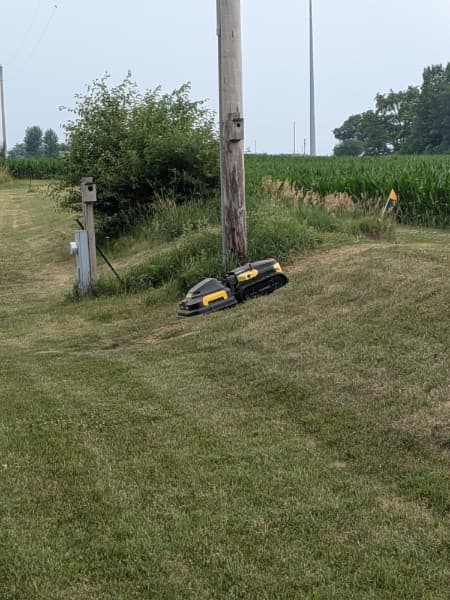

Rollover& Tilt Detection.
30 minutes before the Rain.
Rollover& Tilt Detection - ON
Rover reported a Rollover. Had to unplug battery and go through was feels like 5 minute boot up. As soon as I unplugged the battery the rover rolled forward over my foot. There was no other way to clear Rollover Error and take control of the Rover.
Sure doesn’t look like a Rollover or Tilt to me.

The rain sensor is, well, it kinda doesn’t work for me. It needs to be perfectly clean to register over about 200. It’s a sensor telling you how wet the rover is, not how wet the grass is. The Rain Detection setting doesn’t survive a reboot if you turn it off (not sure if they’ve fixed that).
I turned Rain Detection on and set the threshold to 50 on a sunny day, and the rover started the Work Plan but went right back to the charging station. My sensor bounces all over the place as it turns out, from 3 to 50 or so. I set it to 70, and it’s been OK. I figure what the heck, if I get some rain, it might trigger the 70 threshold and send the rover back to charge. But I’m not relying on it, no.
I’m not entirely sure, but I believe the rain sensor operates on electrical conductivity. Correct me if that’s not the case.
When this type of sensor comes into contact with water, its resistance decreases. These sensors can be effective, but achieving accurate readings typically requires more advanced logic.
First, they usually need to be individually baseline calibrated by determining their resistance when wet and when dry. Then, logic must be applied to interpret resistance trends over time — for instance, rising resistance may indicate the sensor is drying out, while falling resistance suggests increasing moisture, such as when it starts raining.
It doesn’t look like any intelligence is being applied. The sensor appears to be displaying some simple inverse product of the current resistance. This alone isn’t very useful.
