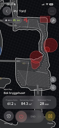

I can see already a massive improvement on Yarbo “traveling” to designated start point. Before it was almost always “crashing” into the no-go zones, or even its own boundary, as the route was obviously too close. But now it actually seems smart, knowing where it is on the map, resulting in much faster and smoother traveling.
Unfortunately, I can see on the preview, that it will still cross the fine pattern, so a bit bummed by that. Why not fix some of the main complaints and make the mower work perfectly. I read a lot of features for the blower - I dont have it, and I think most people have the mower or the snowblower. So dont quite get the priorities here.
See here? There’s absolutely no reason at all for going across the lines. Would take 2 seconds more to just turn around and “travel” along the perimeter. Should be a quite easy fix. Just “dont cross lines” option. The people can choose.
@iamnordic That is being tracked here: Yarbo should try to follow pattern lines when moving between different points

Great, that would have saved me a broken blade mount disc. The one inch wide path line snuck right between the non overlapping no go zones. Yarbo a bit wider than the line it draws…
