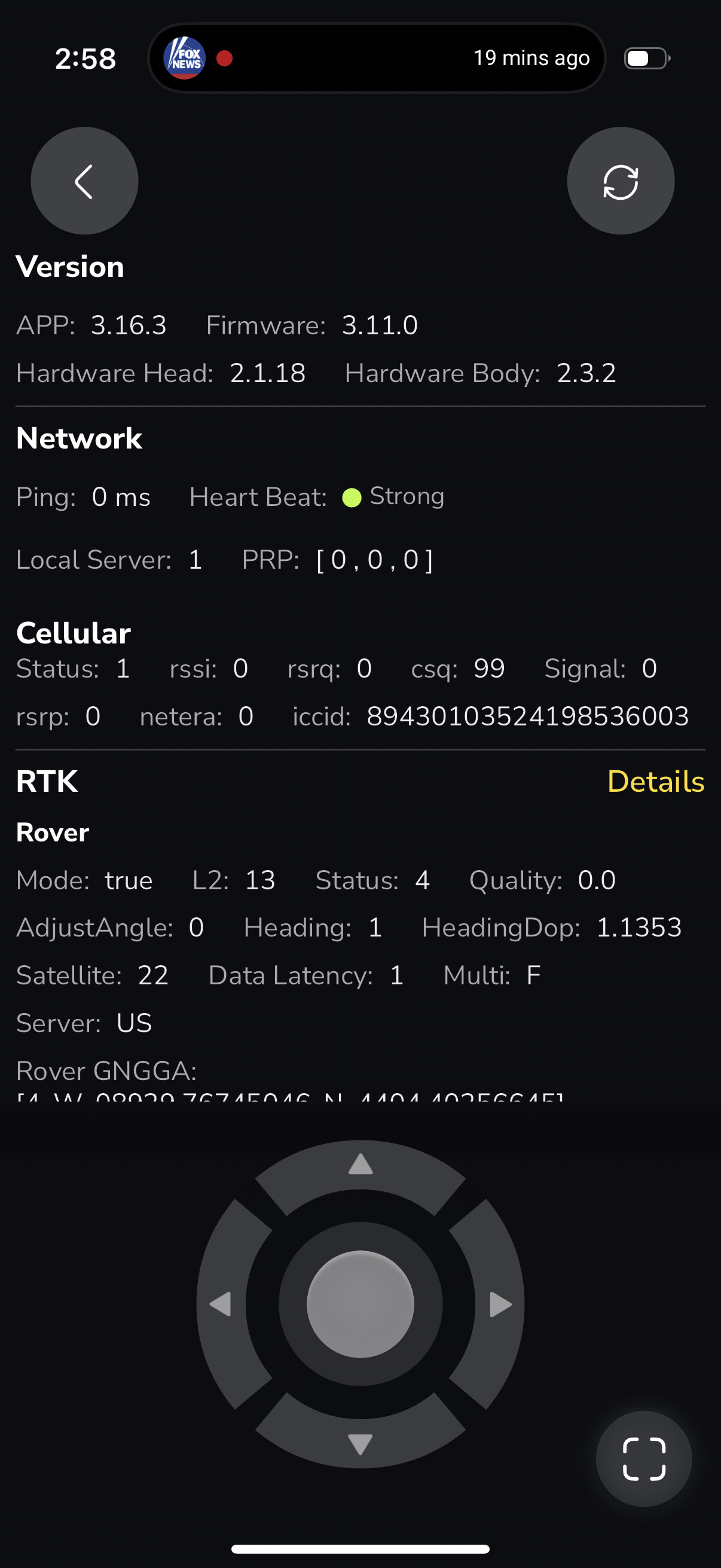

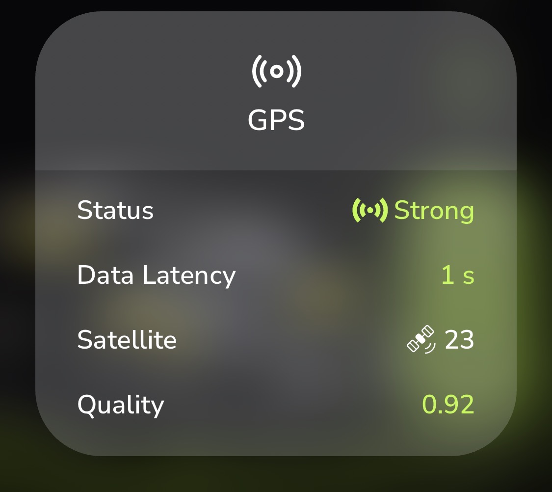

That is long enough for sure. What does your diagnostics screen look like?
This is with PPVS Off
That looks fine, GPS should be green with those readings. Wonder what it would look like with PPVS on? DC Connection status 2 or 3 and Halow -80 or less?
Halow is -41, DC Connection 3. Tried with it on too.
All sounds good. If you rebooted everything, does your DC CNR values look OK? You can throw it in survey mode by clicking details under the RTK section of the diagnostics. You need CNR values for most of the constellations to be around 36 or higher.

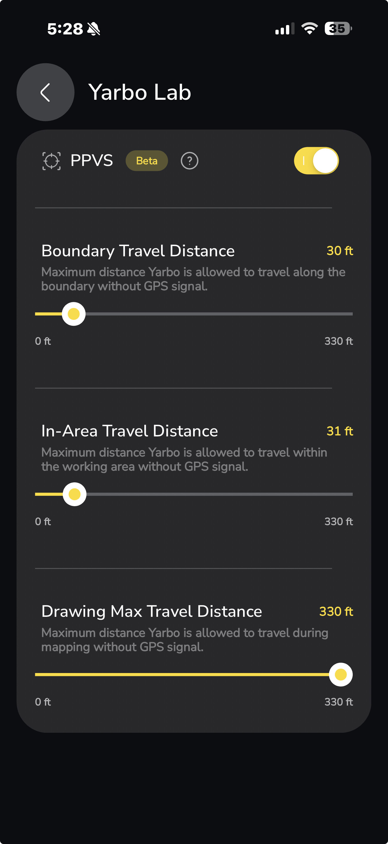

What is your Travel Along Boundary without GPS setting in the Yarbo Lab Tab?
Mine was 0ft and Yarbo would launch and stop because my pad is snug up against a boundary. So with Yellow GPS it stops. So with a boundary distance set to 0ft you HAVE to have green GPS to move. That’s how I see it. I set my boundary travel distance to like 15ft and it has solved that problem for me. Try it out and lemme know if it works for you.
Not getting any GPS, have that turned off right now. I have had that from default to max.
Copy. Set it to something other than zero though. Otherwise I can’t imagine if it were set to zero and you’re outside a boundary how it could move.

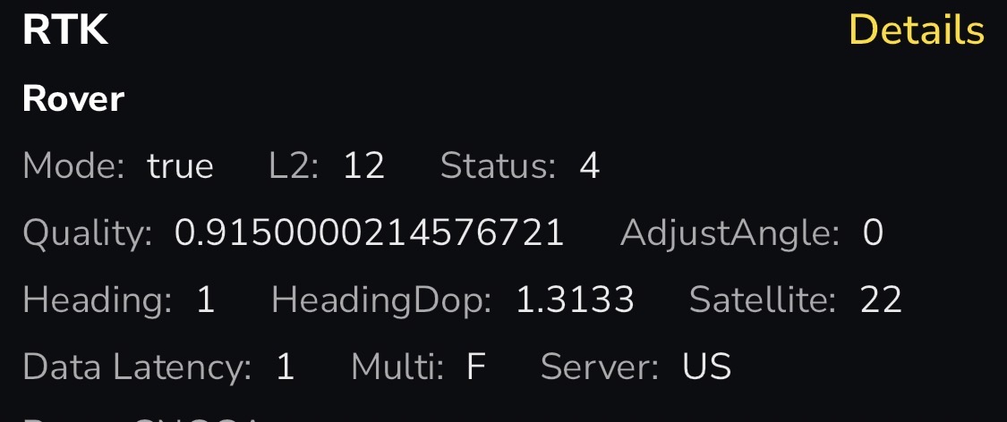

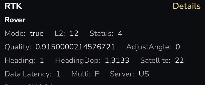

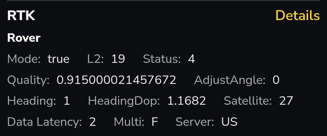

L2=13 is nothing, looks like gps is not fixed and therefore quality is 0.
My L2 =19 sometimes 20 immediately ~2-3 seconds (yellow to green GPS icon on the main screen) after entering required Yarbo unit in the Yarbo app.

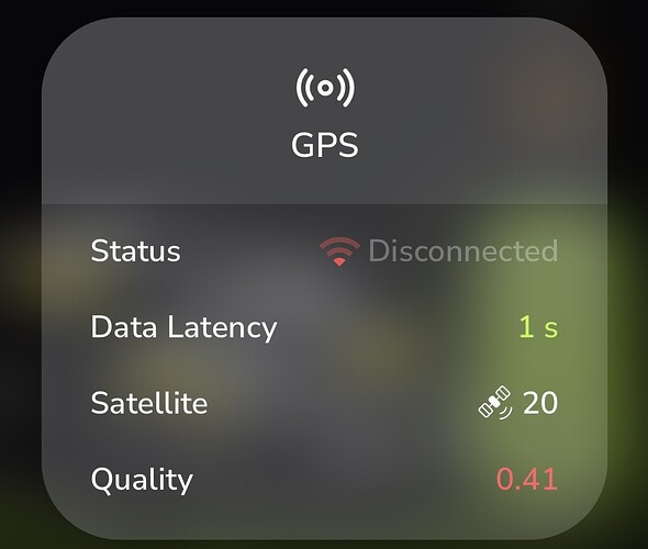

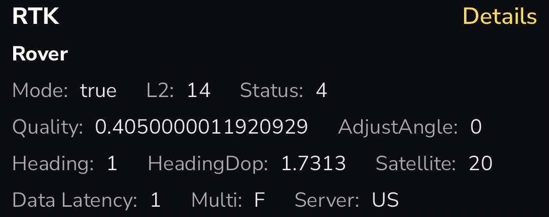

@jso You are not comparing apples to apples - you have Dead Reconning on so that is why you see quality. Turn it off and it will go to zero. 13 L2 is Nothing? Under 4 is the old standard of being too low.
Yup that’s what happens when I toggle PPV on and off. But what are you saying? That Dead Reckoning is doing the heavy lifting and not GPS
