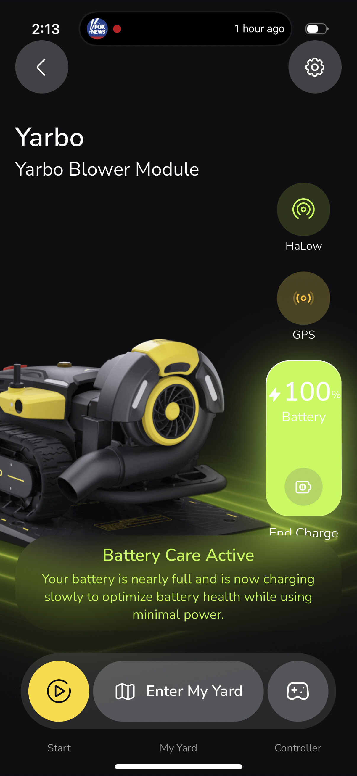

This is new. Any idea how to resolve this? Typical reboot everything didn’t help
