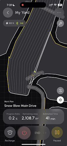

How do I get the snowblower to only go side to side? I don’t want it running the long way on the plan. No matter how I seem to set the throw direction I can’t get it to do it the whole driveway in that fashion. Any suggestions.
See towards the triangle part it switches?
Setting it to only one side on the long end worked best for me. Having it set to both sides really made the pattern wonky. Can you set it along the other long sides vs the shorter sides you have now?
My driveway has obstacles I need to avoid blowing snow onto/into on alternating sides.
Do I need to break the driveway into multiple areas? (One for every time I need to switch the snow blowing direction)
This might work better but you could experiment with mapping it as one area and alternating the snow throwing directions as needed. But just know that it may still throw in an unintended direction when turning or switching throw areas. I believe this is something they are working on refining soon. If you did break up into smaller areas of you keep the throwing direction unbroken along one side it seems to work best and plot a more efficient pattern. But you can set the directions and experiment using preview to see what pattern works best. Inventory get something you like, go into working preferences and switch the auger off, set the auger height to max and run a dry run test to watch and see how it performs. Don’t forget to put everything back once you are happy with how it’s doing.

@bryan.wheeler I have tried all different ways but can’t seem to get the whole driveway blown right to left now matter how I configure the throw.

I don’t want this one! No need to keep throwing all that snow. I’d rather rotate this plan 45°/90°.
What if you split it in half left to right?

Have you tried a different route pattern?
I have not. I will try mapping in a couple of weeks.
I’ve read documentation and it does not seem I can change the snow throwing direction depending on where the Yarbo is in an area.
Is that correct?
It points the chute towards the yellow line along the edge of the area. If there is an absence of a yellow line for it to track, it throws forward. Fairly rudimentary, but effective. If you scroll up and look at some of the other maps posted you will see how moving the yellow line affects the path planning lines. Do you need something more complex?
Have you tried the “route options” under “aera settings” if you put it on circle it might get you more of what you’re looking for.
Otherwise smaller areas might trick it to do the horiz pathing vs long ones
The driveway is 10 feet wide and 120 feet wide.
It seems most logical to travel in long north-south zig zag pattern but that is not critical.
I’m looking to throw snow east for 40 feet then to the west for 50 feet, then to the west for 30 feet.

Hi there, the route is automatically calculated based on the snow blowing direction you select and the shape of the mapped area. You may want to try adjusting the snow throwing direction, or splitting the driveway into two separate areas to see if that helps achieve the side-to-side pattern you’re looking for.
As Bryan mentioned, both methods can work. You can try each one and see which gives you the snow-blowing performance you’re aiming for.
