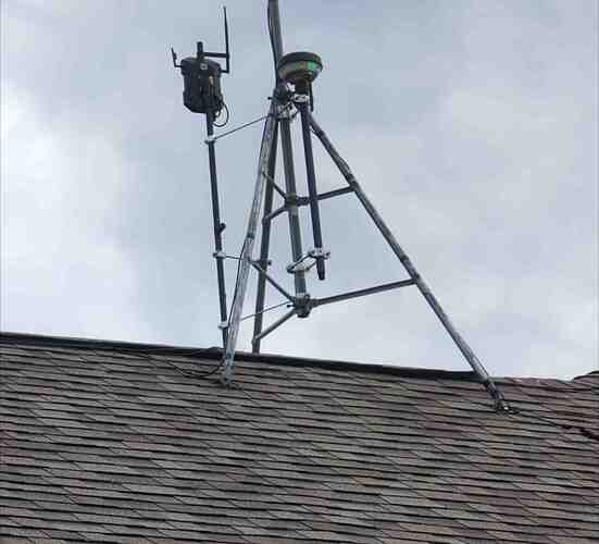

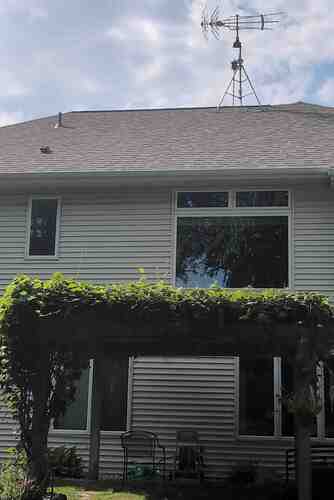

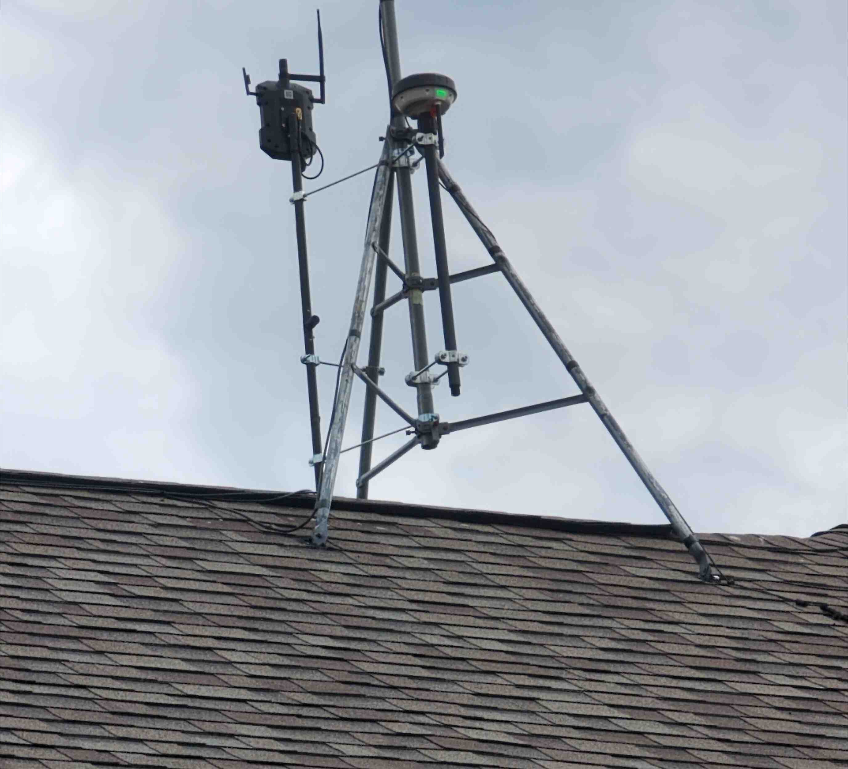

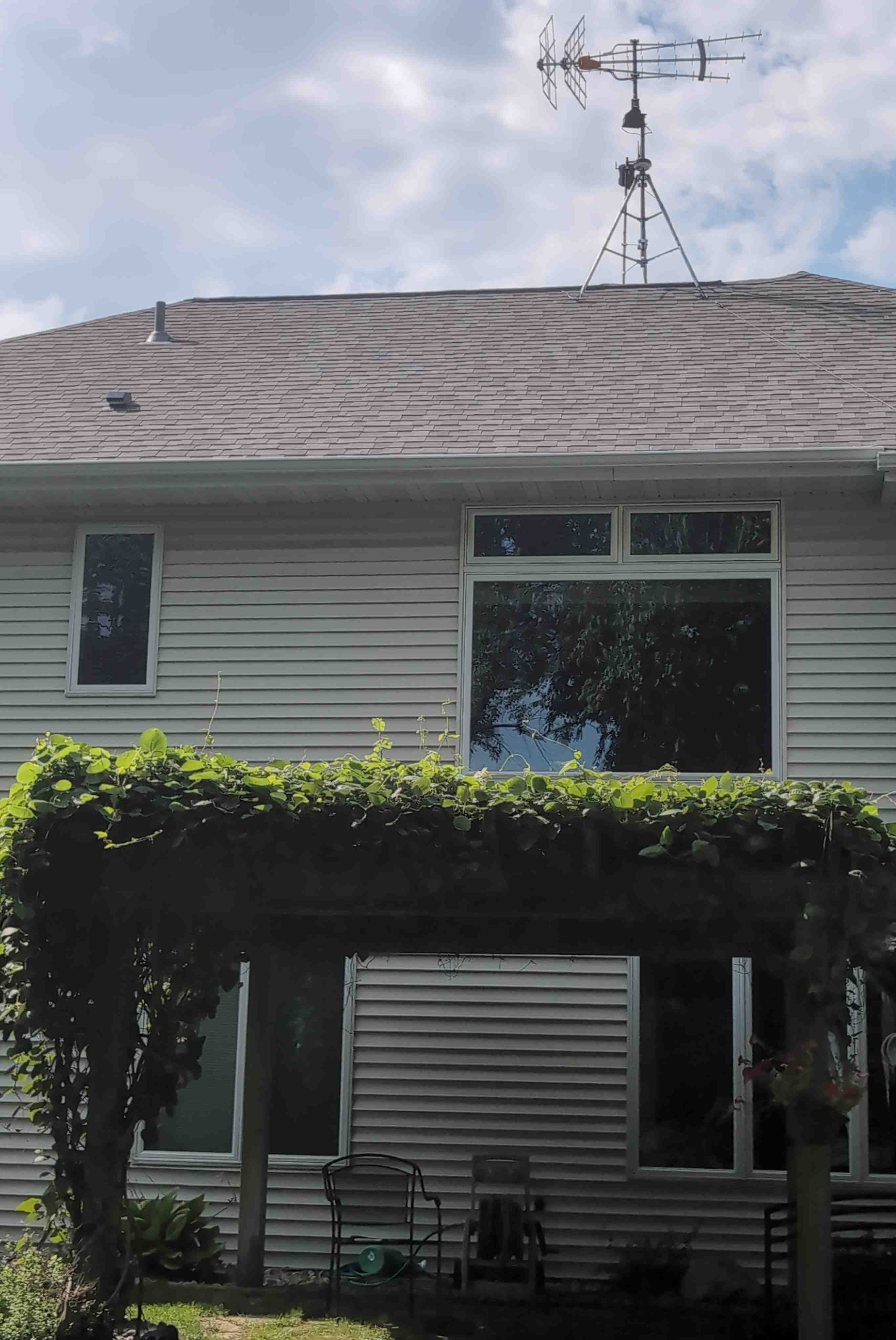

Here is a picture of the installation location:

Yes, just unplug POE injector for 5 mins. Your DC CNR values in the scatter plot are very low. 37 is the minimum for things to work. You want at least 40. What is above the DC on the pole? That might be blocking your signal. Could also be the RTK antenna, but right now I am leaning towards whatever is near it blocking some of the signal. Are you able to strap it to the long pole at the top of that mast? The higher you can get that with the less obstructions above or near it, the better.
Can’t take a photo now, but what is about three feet above the data center is your typical set of horizontal metal poles of a TV antenna.
I will try what you say (once I find someone to go up there to fiddle with it), but I must say: I could more easily understand the theory that the TV antenna structure above the data center is blocking signals to the data center if the Mammotion antenna also had the same problem since it is also sitting below that same TV antenna structure.
The RTK antenna on the data center is the middle antenna in your image. What is the orientation of the TV antenna above it?
“Pointed” to the north, so as you look at that photo, pointed off to your right and to a small degree pointing away from you as the viewer. Both the data center and the Mammotion antenna are under the same “stuff” from the TV antenna.
I’m going to go out on a limb and say your DC RTK antenna might be bad or loose.
