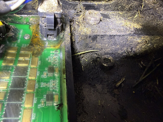

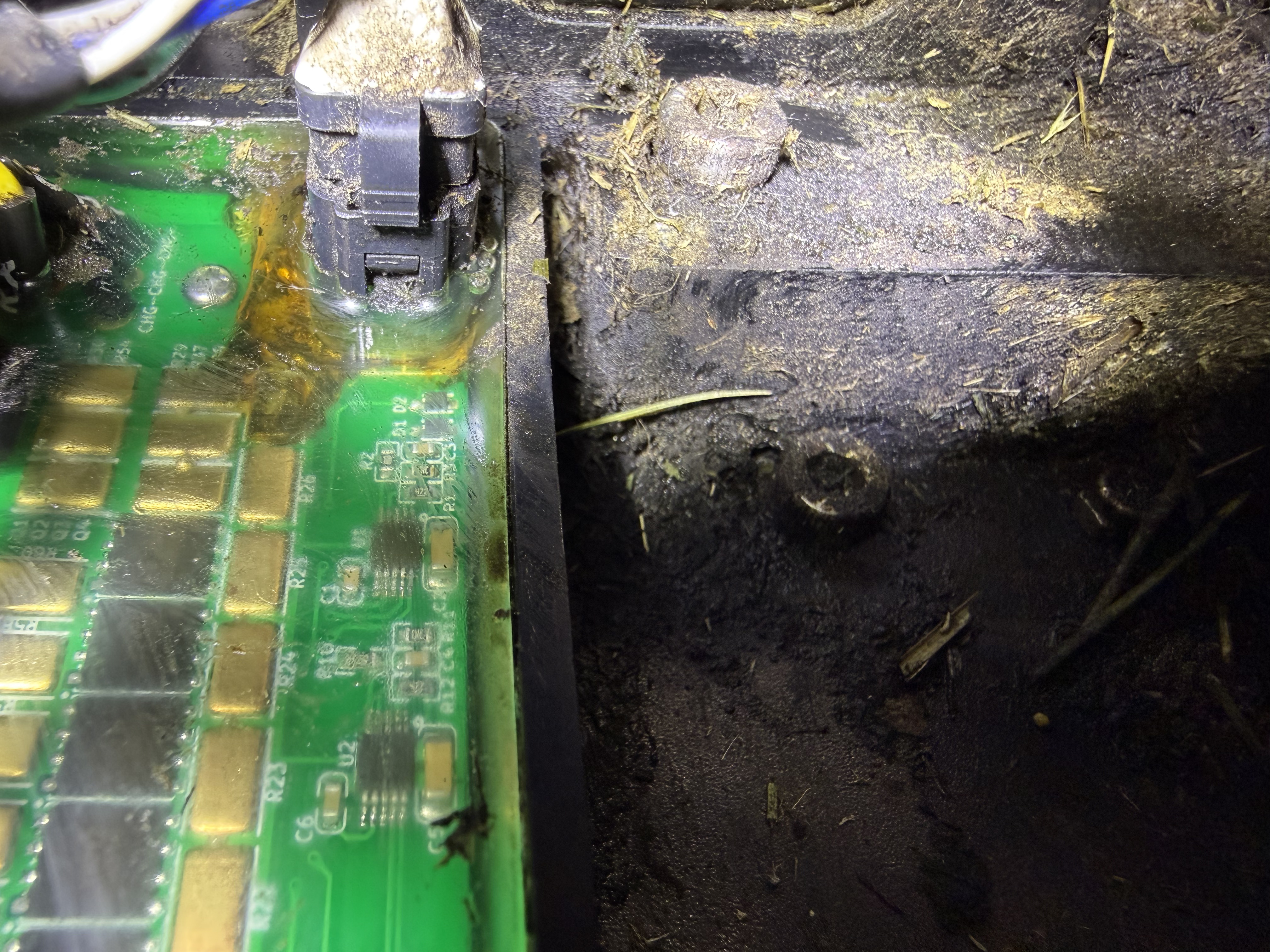

My original core was received 4/21/25 at 10:58 AM and the first mow was May 8th, 2024. Core went offline while docked and charging on 11/22/25. I went to the charging station and could smell smoke. No visible signs of smoke. Looks like maybe some water egress on the power board.
Replacement core (refurbished) arrived today. 11/30/25.

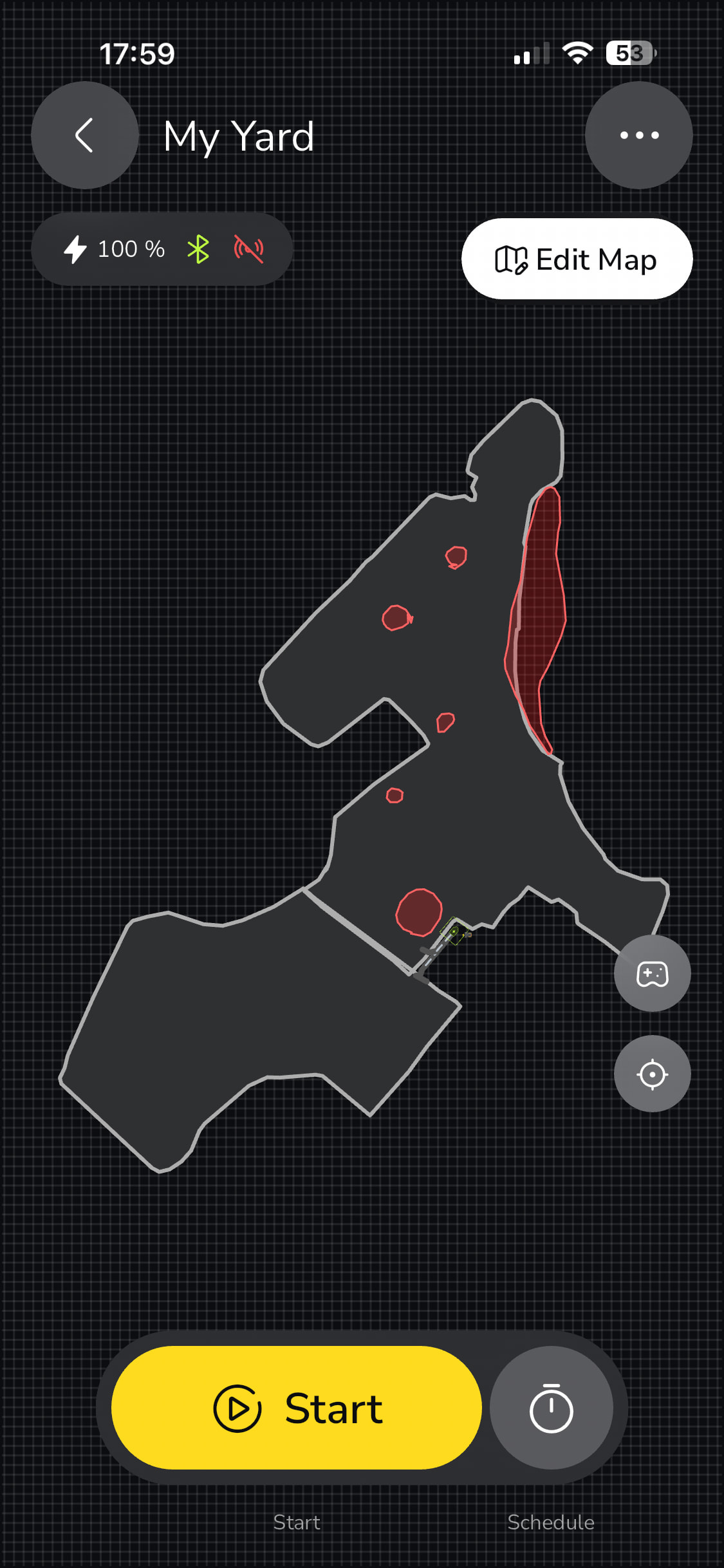

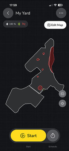

If you recognize these work areas, I have your old core.
If you recognize these work areas as yours could you please DM me what went wrong so I can document it here? Thanks in advance.
But Yarbo swears they improved the security by deleting this info before shipping out refurb units :rofl:
To be fair, these were in the cloud. But your sentiment still sands.
