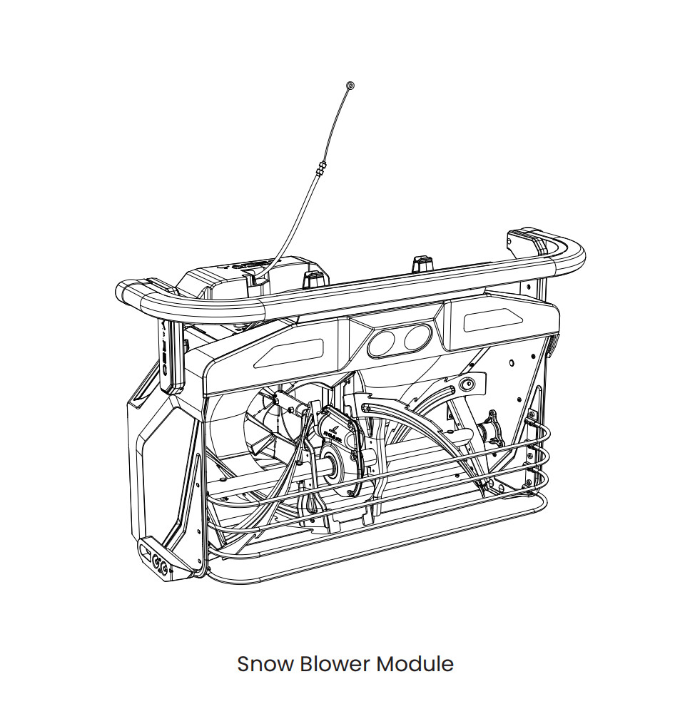

Welcome to the Yarbo Snow Blower Module Removal Guide. This guide provides a step-by-step process for safely removing the snow blower module from your Yarbo Core. By following these instructions, you can ensure a smooth and damage-free removal process. Please read each step carefully before proceeding and take all necessary safety precautions.
Pre-removal caution: Before starting the removal process, ensure the Snow Blower Module is positioned such that its surface is in full contact with the ground and the Yarbo is turned off. This prevents accidental falls and damage during disassembly.
