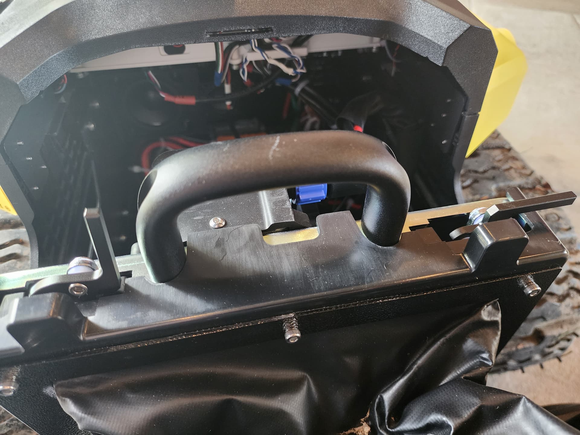

Hi @Stone - I walked through this just now, refined my thoughts, and grabbed some pictures.
  1. Relax the pins. For me that was putting the mower head all the way down (use the App or Y/A buttons on the controller). You are probably going to set the pitch down/forward all the way as well, I’d imagine, if a flat floor like mine.
  2. Remove the rubber cover. Disconnect the power cable (twist the blue collar and pull).
  3. If you want to and can, grab the small handle and hold it steady, else the module might pop forward a little and startle you as it slips off the top pins when you release the latches. I didn’t hold that handle, and the module popped forward, but it didn’t seem to be a huge problem. It can be awkward trying to hold that handle while releasing the latches. Others can correct me on the process here and if one MUST try to hold the handle back and let it down gently.
    Now release the latches.
    The top of the module pops forward and off the pins.
    Leave the latches open.
  4. Grab the small handle and the front underneath of the machine (not too far under where the blades are, of course).
  5. Tilt the front up a ways, pretty much back onto the top pins, until the bottom pins pop out.
  6. Tilt the front back down, module is off.
Does this make sense and help?
I agree, after undoing the latches it feels “stuck.” The key is getting a little leverage by lifting the front and steadying it with the small handle, and it’ll pop off the bottom pins. There’s really no wiggling or anything, it’s very straightforward, at least it was for me. And it really isn’t all that heavy.
I lifted my mower module from the front/side handles, just to get the angle right and the pins slipped right out. Just take it off enough to remove the connector.
It is a bit of a pain, but shouldn’t be a heavy/challenging task.
