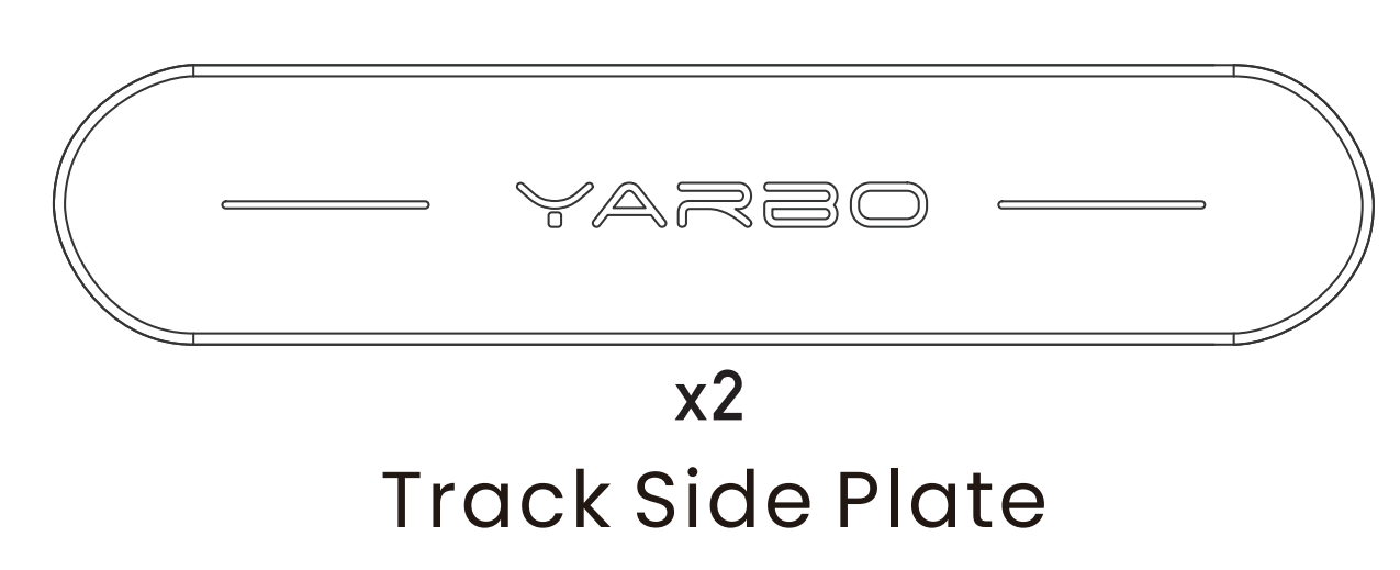

Step 1: Gather the Tools
  • You will need a Allen Key#2 that fits the screws used on the Track Side Plates.
  • Ensure you have the replacement metal Track Side Plates ready.

Step 3: Replace with Metal Track Side Plates
  • Position the Metal Side Plate : Place the new metal Track Side Plate in the same position where
    the plastic one was removed.
  • Secure with Screws : Use the same screws to securely attach the metal Track Side Plate. Make sure the screws are tightened properly to avoid any movement during Yarbo’s operation.
