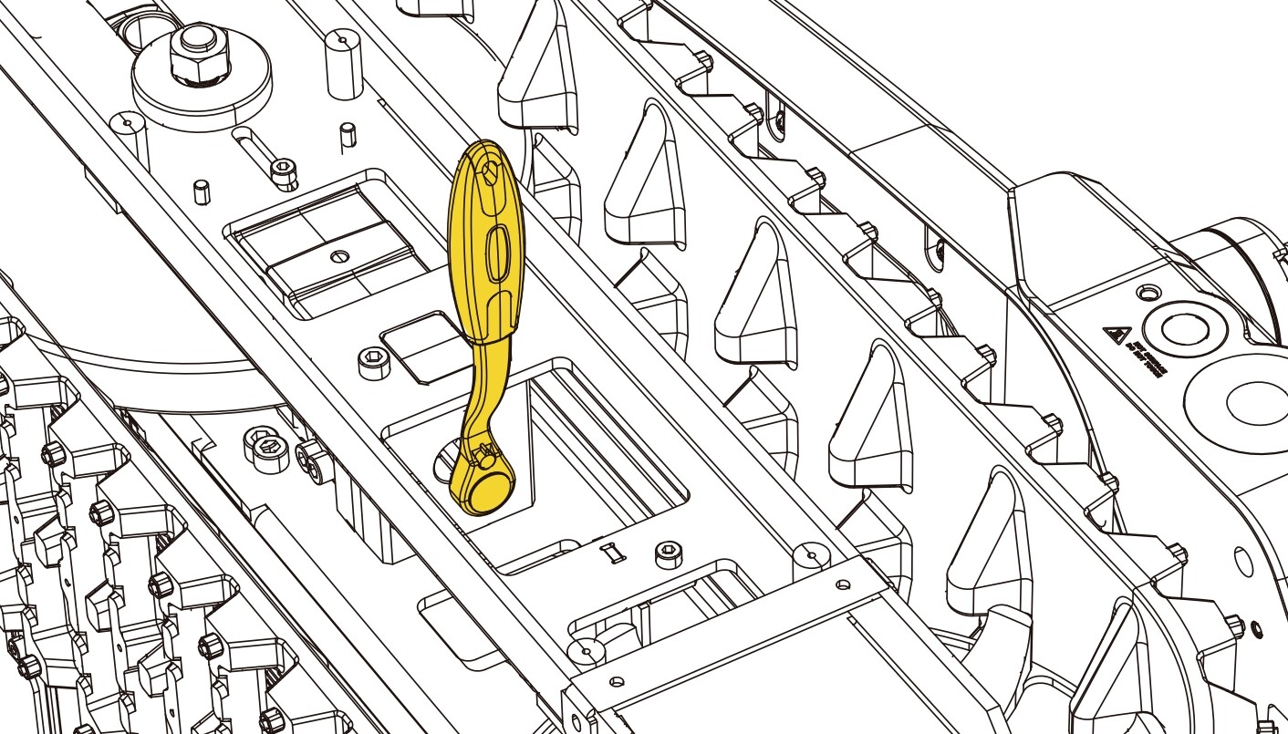

Step 2: Loosen the track fixing structure
Using an L-shaped socket wrench, carefully loosen the screws, securing the track fixing structure. At this stage, avoid fully removing the screws, as this step is intended to remove the nuts.
This will allow some flexibility for the next steps.

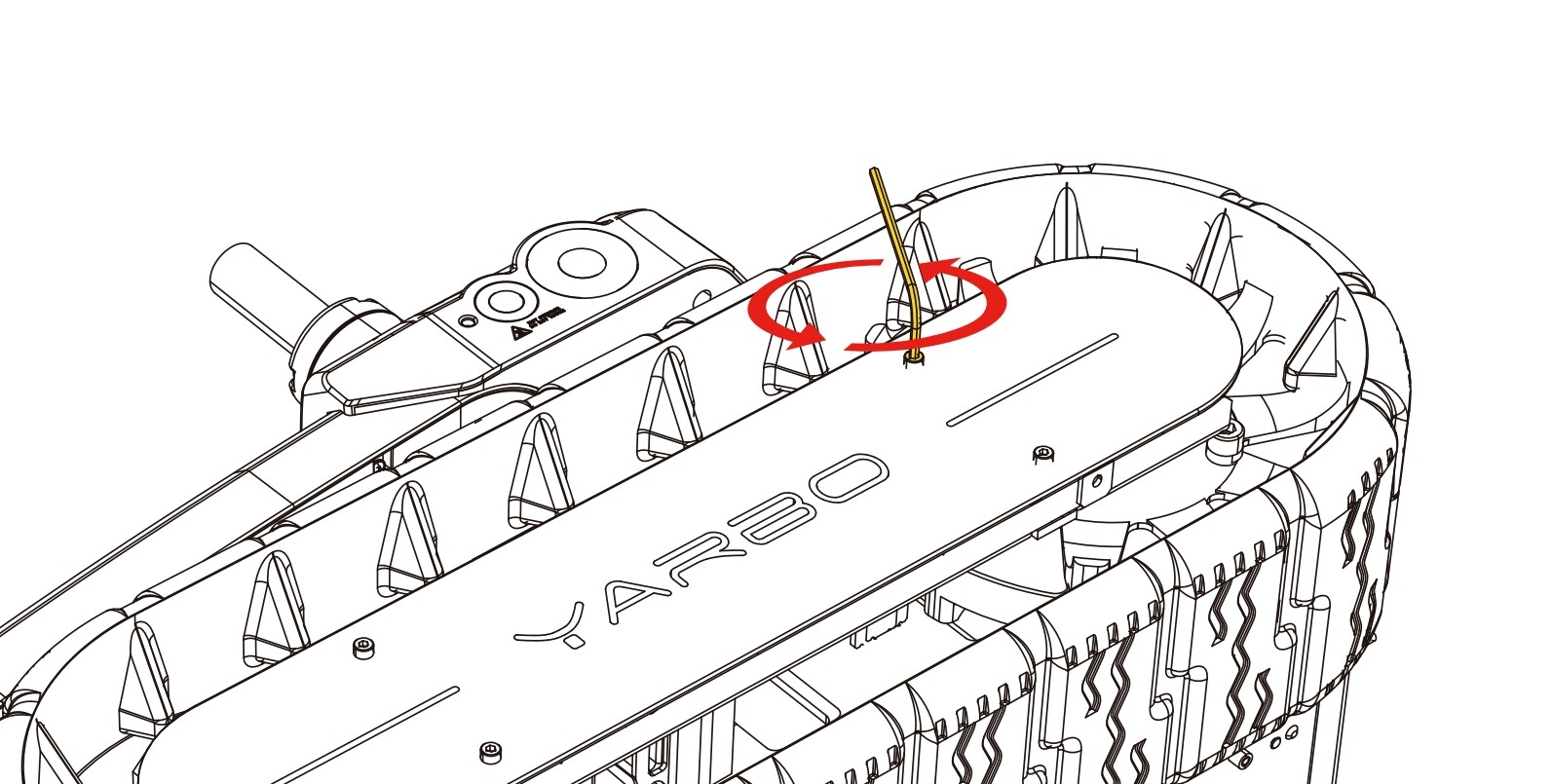

Step 3: Remove track fixing screws
Next, take Allen Key #3 and fully unscrew the track fixing structure. Make sure to set these screws aside safely.
Step 4: Loosen track fixing structure
Using the track wrench, loosen the remaining screws that hold the track in place, do not remove the screws completely yet.
This step will help release tension in the track
