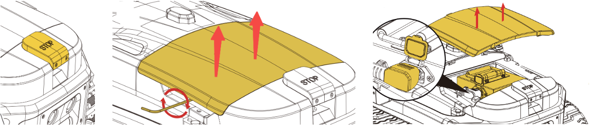

Before disconnecting the battery power cable, make sure Yarbo is not in operation and the emergency stop button has been pressed. Then, open Yarbo’s power cover and manually disconnect the battery power cable to power off Yarbo. - Manual Shutdown(2)
