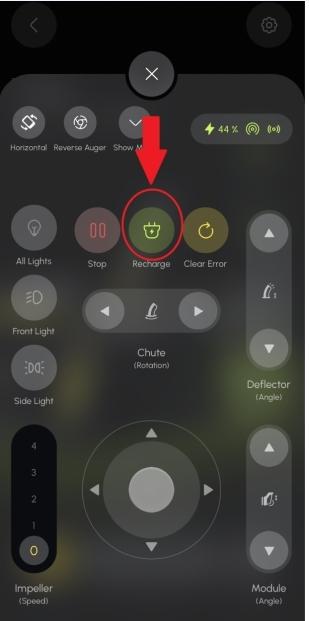

2. Using the App Controller: If you’re controlling Yarbo via the mobile app, navigate to Controller > Recharge. Yarbo will announce “ready to charge” and “start charging” and will start charging automatically.

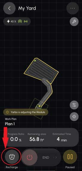

3. Using the Recharge Button on the App Map: If Yarbo is within the mapped area of the app (the designated work area, pathway, or docking station green box), simply tap the Recharge button to initiate charging. If Yarbo is outside this mapped area, manually drive it back into the map area before using the Recharge function.
