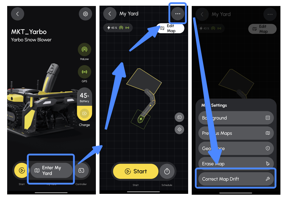

How to Correct Map Drift :
  1. Make Sure Your Yarbo is Parked Accurately on the Docking Station If map drift occurs, you will need to manually maneuver your Yarbo. you will need to park your Yarbo exactly on the Docking Station.
  2. Operating on the Yarbo APP You can go to the “My Yard” map, find the settings option and select the “Correct Map Drift” option. Click on it and wait for a while, your Yarbo will correct the map automatically!
By taking these steps, you can work towards ensuring that the app’s map more accurately represents Yarbo’s true position.
