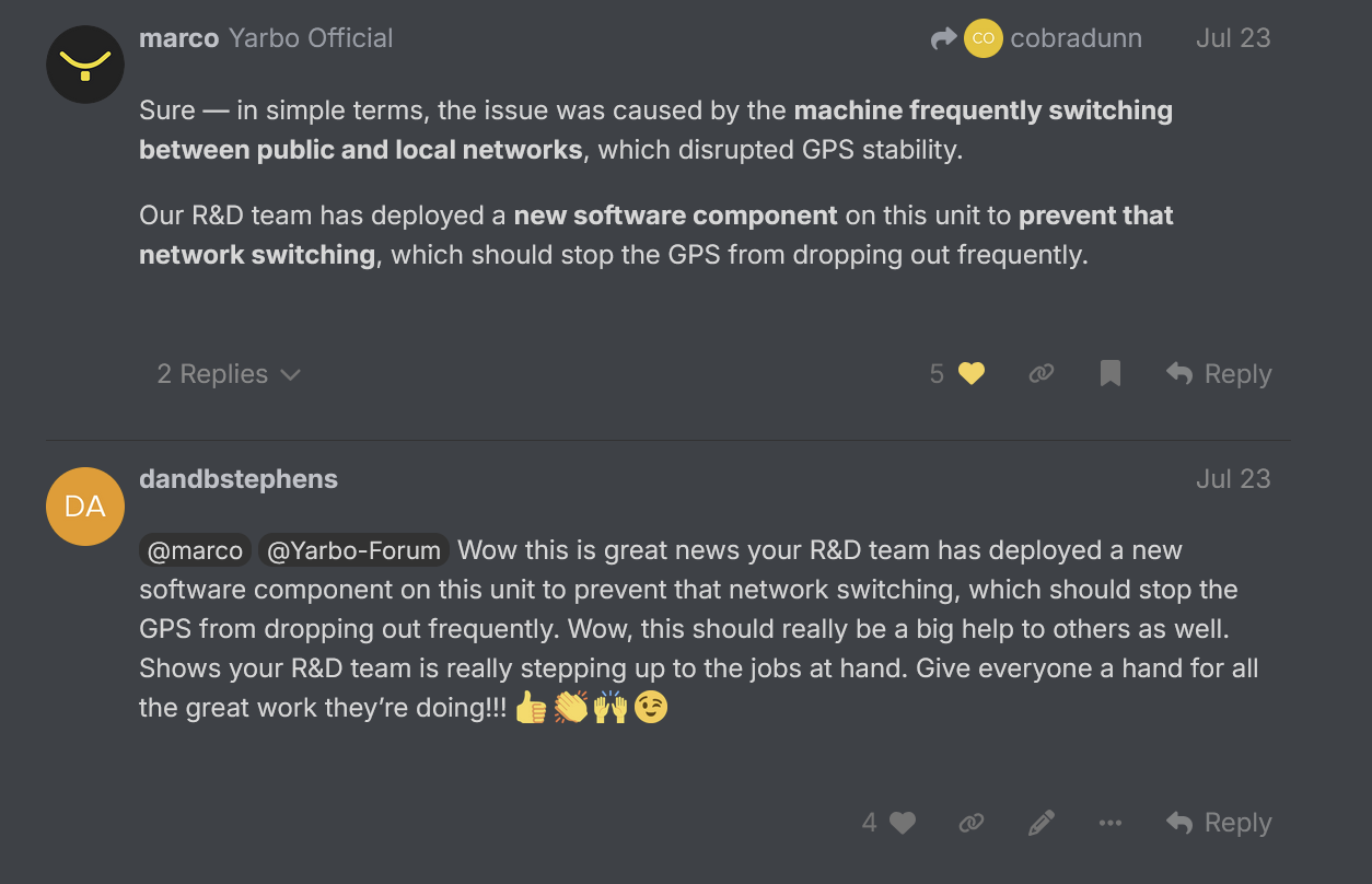

@Yarbo-Forum @marco @bryan.wheeler Update. Well I wish it would have been an easy fix. He’s still about 6 feet off. So I deleted, and doing a remap now. Or should I say trying. But, I looked at the numbers again. I do see a smaller amount of what was happening before with the latency bouncing up more than the other core. Before they fixed it remote so it would stay stable. Now it stays at 1 some of the time. But is climbing to 21, then back to 1. After the fix they did, it was staying calm. Don’t know if the new core or what. Biggest issue is not being able to remap. So I got clear sky about 1/3 of an acre done. Many stops, and goes. But finally after 2 hours it’s done. But trying the other with anything in the area, tree, bush, building, car, flea, ant, dog, fly, it’s so unstable after 5 tries in the area, clockwise, and counter clockwise. No Go! This unstable GPS is not a happening thing.:thinking: So I’ll reach out to them Once again, and see if they can see what happened with the transfer. Ticket numbers #91428,#113257,#109358

Hi there—sorry for the wait on a solution. Regarding Ticket #114007, your case has been escalated to our R&D team for a remote fix (as we did last time), and this process can take a bit of time. Please rest assured we understand your need for a quick resolution, and we truly appreciate your patience and understanding.
@Yarbo-Forum @marco We can’t do what we did to get this working. This has happened before. Do we have any notes left on what it took to fix like before?:thinking:
Hi there. Although the behavior looks similar, the root cause may vary. I’ll share the past handling records with the engineer on your current ticket so they can review and reference the previous remote fix.
Thanks @marco. I appreciate you helping pass along the previous notes. Thanks again to everyone helping correct the issues. Remapping everything again will be a choir. Just ready to get him off the charging pad and back to work. He’s been sitting almost two weeks now. Thanks again.:wink:
