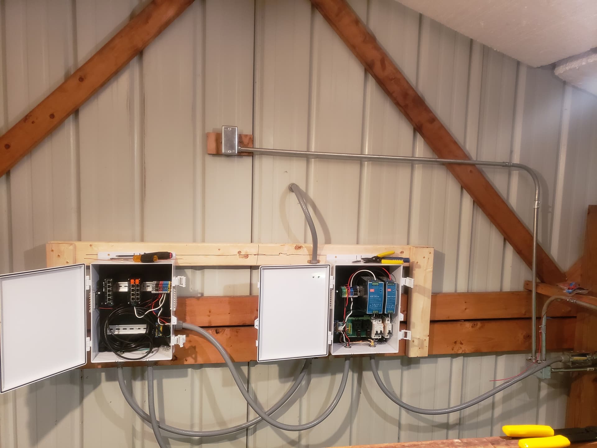

So over the last few weeks I’ve been adding electrical runs and network access to the pole building on my property, and I just turned everything on for the first time last night and plugged in the data center. This evening I’ll setup the charging pad and put the battery in the rover. It’s been quite a bit of work running all that conduit and cable, and putting in the network equipment, but I’m hopeful that this will all be worth it in the end. :blush:

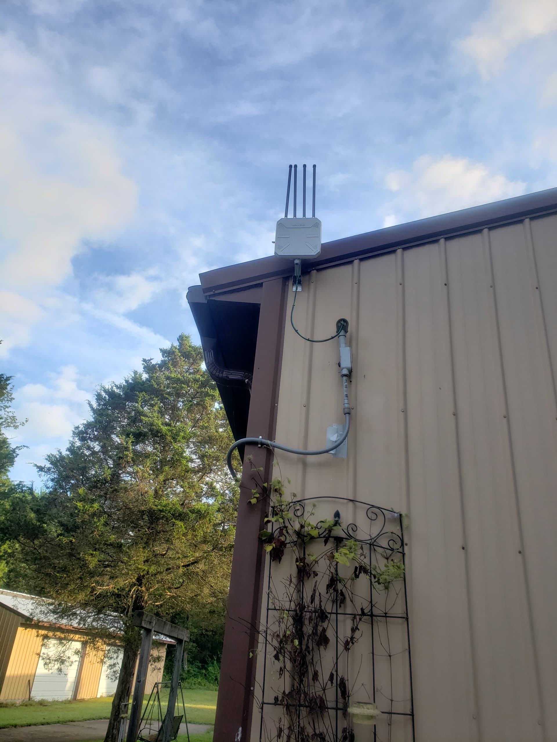

Looking at your photos, it looks like your data center may not have an unobstructed 120 degree view sky.
That may cause issues down the road.
You might need to relocate the DC because of that tree. There is a survey mode in the app when you do the data center install. Keep an eye on the CNR value at the bottom of the meter. You want 40+ for the best signal. The DC needs 120 degrees clear view of the sky. The rover needs 7ft of clearance all around and a clear view as well on the docking station. Something to keep in mind.
Mines in the garage attic. Haven’t had a bit of a problem.

Ya, when I turned it on last night I got the blinking red light on the DC and the signal meter only only went half way up the graph… which is unfortunate. There’s really only one other location with a better view of the sky, but that means putting holes in my house and it’s at one edge of my property. I specifically didn’t choose that location because I feared that with the terrain and the structures that the communication between the DC and the rover would be obstructed for the largest portion of the yard I wish to mow… But it looks like I may not have any choice. I may be able to move the DC to the other end of the pole building and get a better view, but that’s 100’ away and I’d need new cables… Such is life, yes? :sweat_smile:
Also, getting 7’ clearance for the charger AND an unobstructed view will be nearly impossible unless I just put it out in the middle of one of the two open yards. And even that depends on your definition of “open view” :wink:
The rover and data center don’t need line of sight to each other. They just need to see the same satellites. Regarding the dock, you can park the rover where you want to setup the dock. If you have 10+ L2 satellites and an Heading DOP of below 1.5 several times of the day, you should be good to use that spot. 7FT is the general rule, but you can fudge that some in the rear and sides. It does need to 3 point or zero turn directly in front of the dock though. There is a turn test when you setup the dock. Give it a test.
When I had it up last night, it was fluctuating between 22 and 23 satellites, but the DOP didn’t show a value…. I think. That was 10 hours and a sleep cycle ago and I wasn’t exactly paying attention to details as I was shutting down for the night and was already up way later than I would normally. I figured some of that was because I was unable (the app wouldn’t let me) to set up the DC, I’m assuming because of the low signal quality.

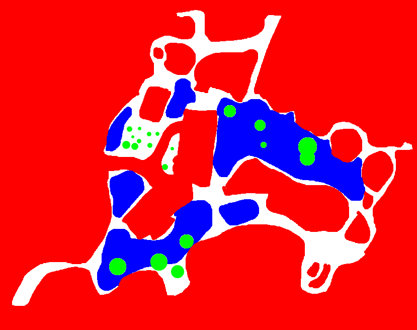

Just for reference, here is a ROUGH sketch of my yard. Red is no go, Green are large trees (canopy, not trunk), and Blue are the “open” areas…. I wasn’t kidding when I said it was complex. :sweat_smile:
Well, yesterday I moved the DC out to the center of the roof and was able to get a green light. Yay! Took me most of the day to do it and had to reinforce the roof where I was tying the antenna mount to, but I got there.

The metal roof could be causing issues with your satellite and RTK signals. Metal surfaces can reflect, absorb, or scatter these signals. Something to consider.
If that is indeed causing a problem here, I’m not sure what I’m going to do. There is a spot on my house I could mount the DC, but it has a more obstructed view of the sky than the current location. I’ll have to think about that a little and see if I can come up with a potential RF solution to that issue. My hope would be with the angles of the roof, the height of the surrounding trees, and the height of the antenna off the roof, that most of that kind of interference wouldn’t be too much of a problem.
I wouldn’t abandon your current plan. Just keep the metal roof in mind if you continue to have issues.
The roof is definitely not your current issue. It’s with the rover. You’ll probably be fine and a mitigation could be some sort of coating to help absorb the signals instead of reflect them. Any plastic or wood could also help. But I think it’s high enough you might be ok. How does your DC diagnostics look? You can access that from inside diagnose tools under the RTK section. It’s the yellow details link.
How can you definitively say the roof isn’t causing the rover issue? What reading are you basing that on? The roof could absolutely cause the rover to see nothing. It’s not the most likely cause but it is a possibility.
