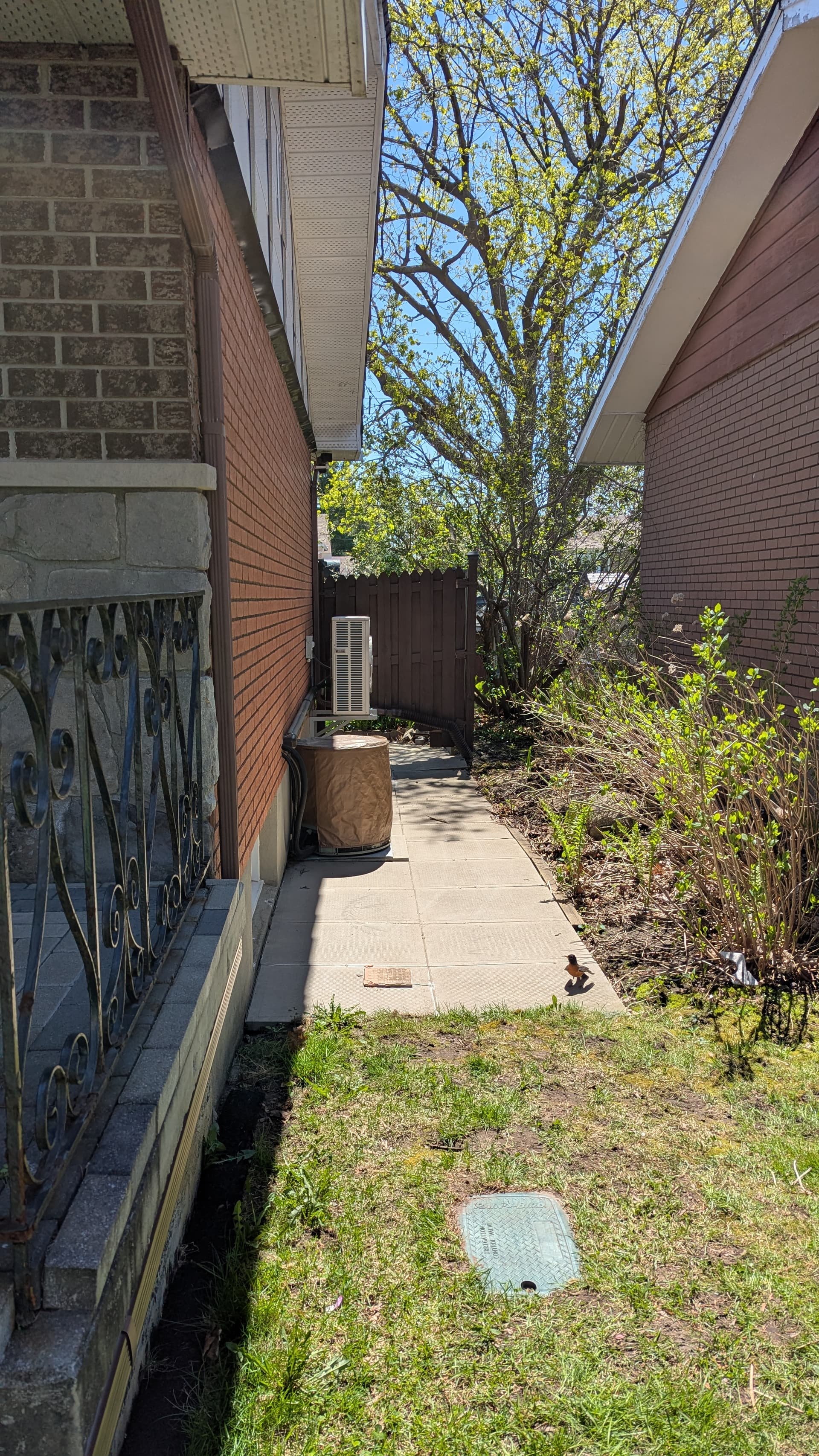

I live in suburbia on a 70’ x 100’ property .. bungalow roughly in the middle … Backyard has a huge maple that currently is budding so gps is ok but will soon be gone for the yarbo unit.
Issue: .. gps, gps, gps … Makes no sense to me that with the data center, cameras, sensors, yarbo is useless without gps…

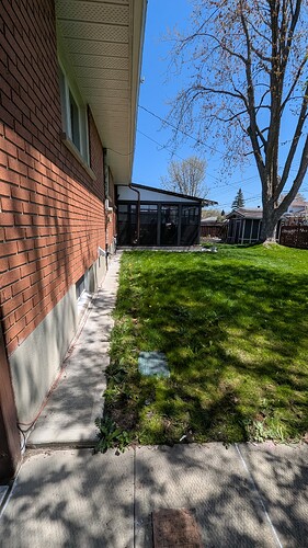

I was able to create a map zone for my front yard but cannot create a pathway due to gps dropout navigating between my House and neighbours house → soffits only allow maybe a meter of sky width from ground (tablet, cellphone, don’t lose gps even if resting on Yarbo when yarbo has no gps… Go figure). Really crappy as there is only about 6 feet distance of straight forward movement that will never ever have GPS
Can’t create a backyard map as tree, soffits, shed cause GPS dropout …

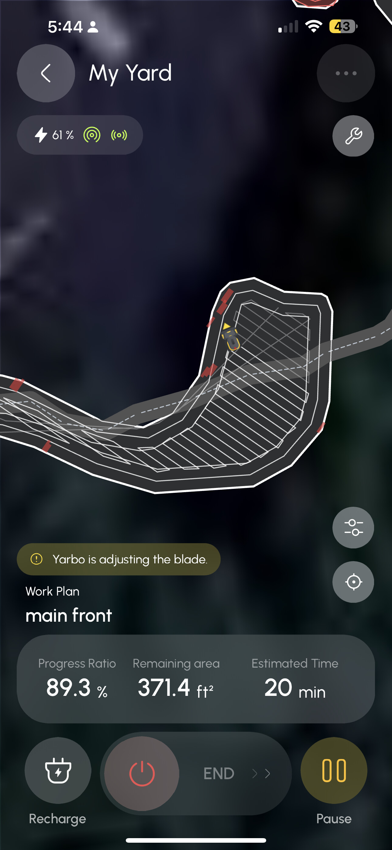

It’s stuck here for now posting the screen shot adjusting the cutting blade state.

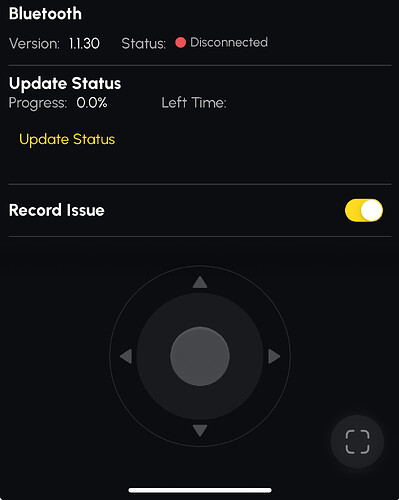

I’ve enabled the issue recording, but I’m not sure what it actually captures.
I don’t see any logs that I can collect or share. The heartbeat signal is always strong.
The wait for blade error is most likely a bug. I’d make sure you have a ticket open for it.

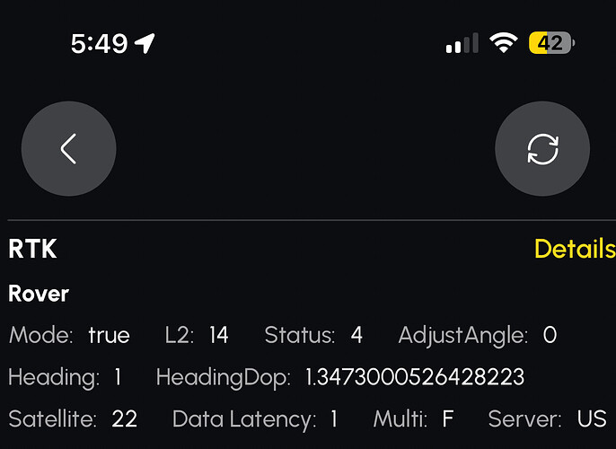

As for the GPS, everything looks fine in the pictures you have provided. You could enable issue record for the job and turn it off when done. Le support know what time you started and note the times of the problems. That will help them narrow done the problems.
thanks, this was captured at gps lost signal at my other area now.
The AdjustAngle -2, when all the GPS/RTK is good, is a known bug that’ll hopefully get resolved in the next update.

Basically anytime I get near being under the soffit of the shed or house GPS dies…

I suspect that tree might be causing you some issues with the DC’s view of the satellites. You ideally need 120 degree view of the sky. Like an inverted upside triangle from the center of the top of the DC.
