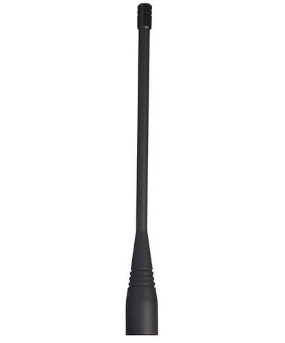

As someone that has used RTK for 20 years+, I can say there are flexible antennas. Actually, every one that I have used had one except the Yarbo. This seems like a design flaw to me with the amount of people I see breaking antennas. I’m using them on GPS units, but it should be the same basic concept. I attached a picture of a GPS antenna. It just screws on and off, similar to your antenna, but it’s threaded metal at the bottom. If I start breaking antennas, I may look into finding a way to incorporate something like this.
The antennas on the Yarbo are powered devices with onboard 20-something-db amplifiers across 3 bands and noise reduction.
