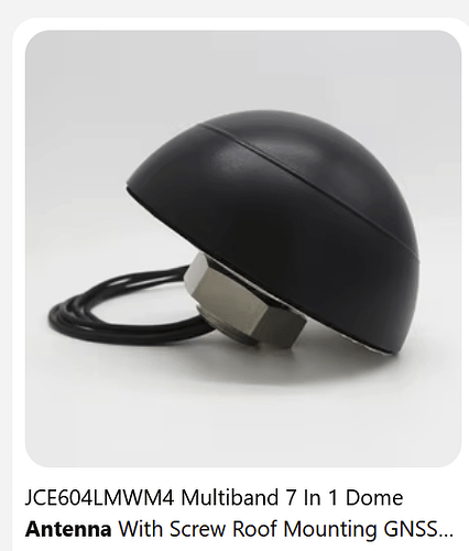

I’ve suggested to them in the past that they consider these types of survey grade antennas and use a heated ground plane to melt the snow. Not sure if that’s feasible or not, but it’s a thought.
