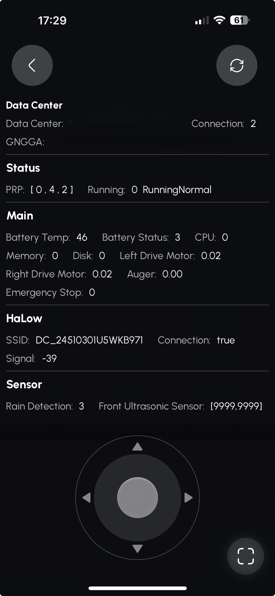

Data Center HaLow signal strength suddenly increased.
My HaLow signal while charging is usually -65.
SUDDENLY its -39.
I have changed nothing…
Is it a sign of my DC’s early demise?
Any advice is appreciated…
