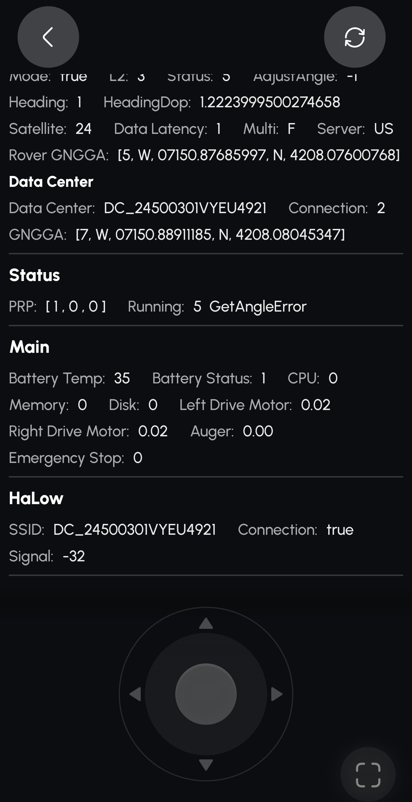

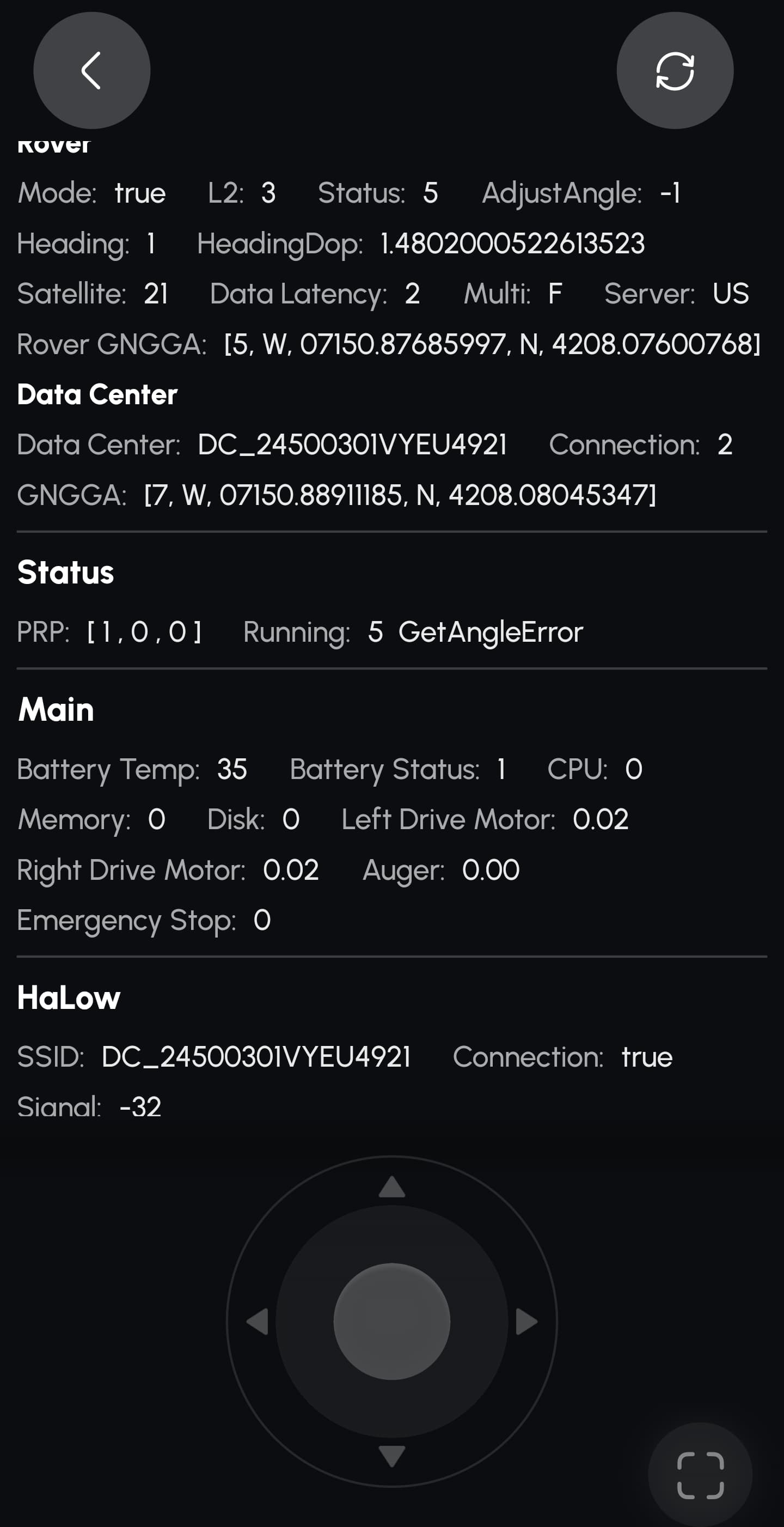

If you can supply a screenshot of your Diagnostics page when the rover isn’t happy (scroll down to get everything, and you can paint out the CNGGA numbers and DC_xx numbers), we can take a quick look to see what’s going on.
It was stalled under a tree when I snipped those screens, a few seconds later it started up, drove straight out of bounds and murdered my poor plastic pink flamingo before banging into a deck railing post lol
I backed it out of that situation, drive it to the center of the yard, resumed and it finished the plan with no further issues at all
With those L2 numbers I’m not surprised. You should submit a ticket and supply the time that happened. Should not have happened with that low of GPS satellites and that RTK status.
It does look like it’s a GPS only issue from what I’m seeing though. Nothing you can do about that but just let it wait and the satellites will move enough for it to get signal again and start back up. Hopefully not like it did previously.
