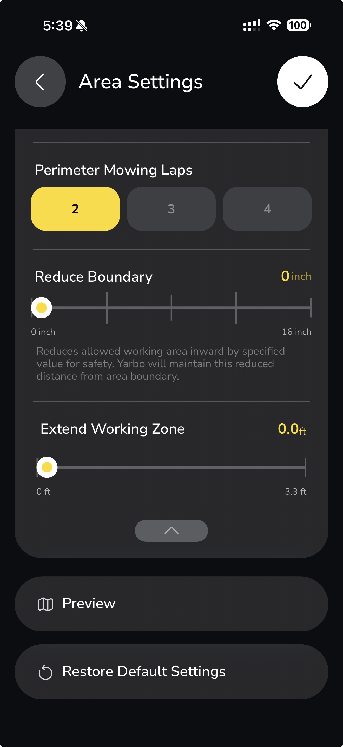

You have the reduce boundary under the advanced area settings set to zero?
Hi there,
As Bryan mentioned, could you please check if the Reduce Boundary setting is set to zero? After the recent update, setting it to zero should make the mower closely follow the boundary you mapped out.
I do have it set to zero. When mapping, it’s possible I didn’t get close enough. I don’t need to add much.
Do I go ahead and split it, take some off and then add it back on maybe?
The edit map can be tricky. I posted Yarbo’s video further up in the thread on how to do each of the three different methods. If the area is small enough or you don’t mind, you can just remap the area. The boundary line it draws is the center of the core in between the antennas. If you drop one of the tracks on the driveway, you’ll probably get it all when it runs. It does turn wide, so it will miss some in the turns. Alternatively, you could try a dead end to cleanup the missed line.
