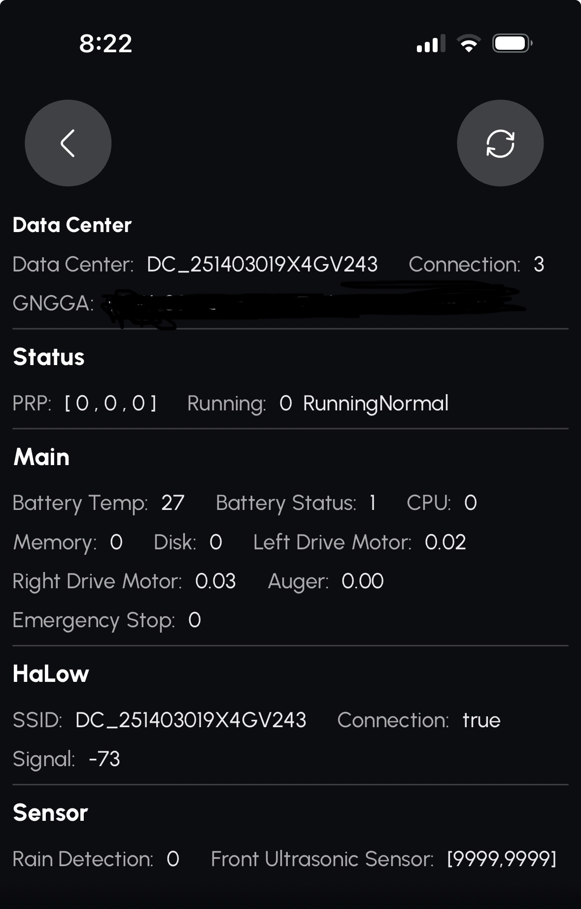

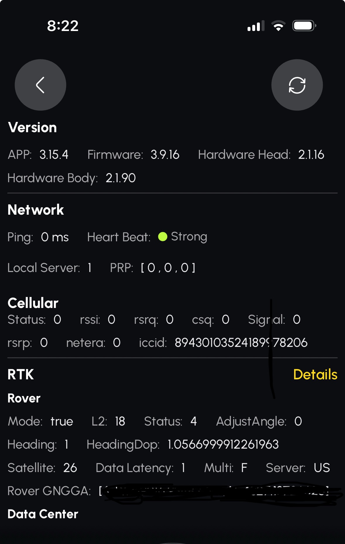

Let’s see if we can find a problem and maybe solve it. Can you provide a screenshot of your DC diagnostics (can access from the diagnostics screen)? Please show the install location of your data center and if you can show a screenshot of your diagnostic page at your dock (include RTK, status, data center, and halow sections) and also include a screenshot of it under a problem area. You can blur out the GNGGA sections (GPS coordinates).

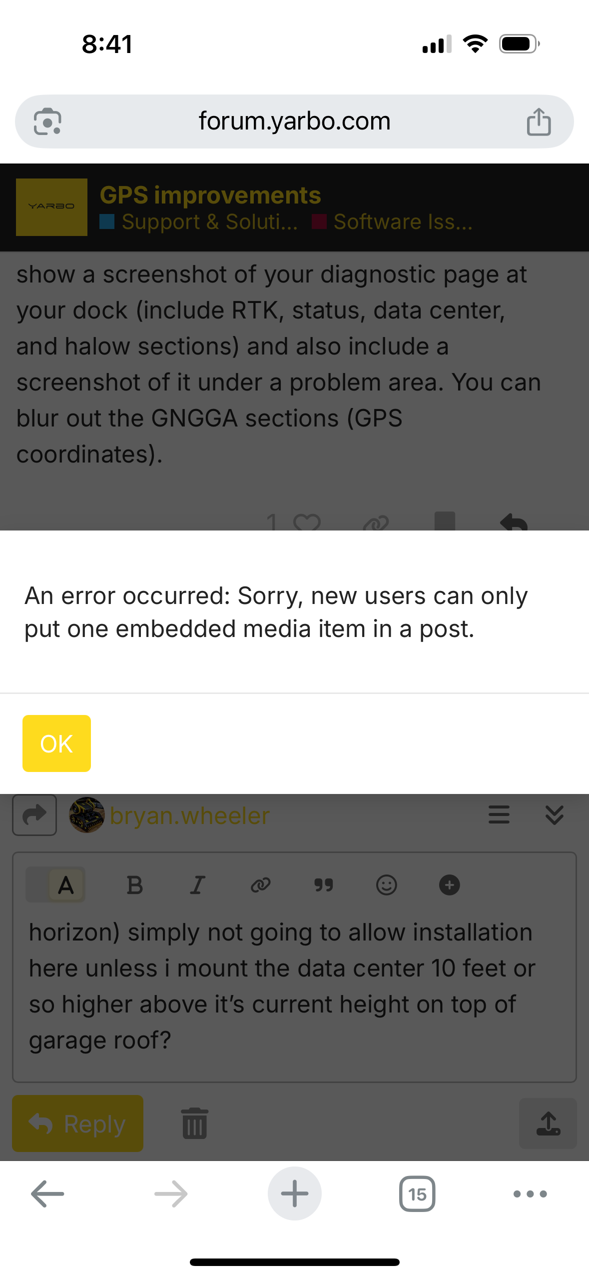

I tried replying with the screenshots and photos but got this error message when I tried to post:
Well there’s that…
Yeah just post one picture at a time. You can’t put multiple yet until you’ve leveled up some.

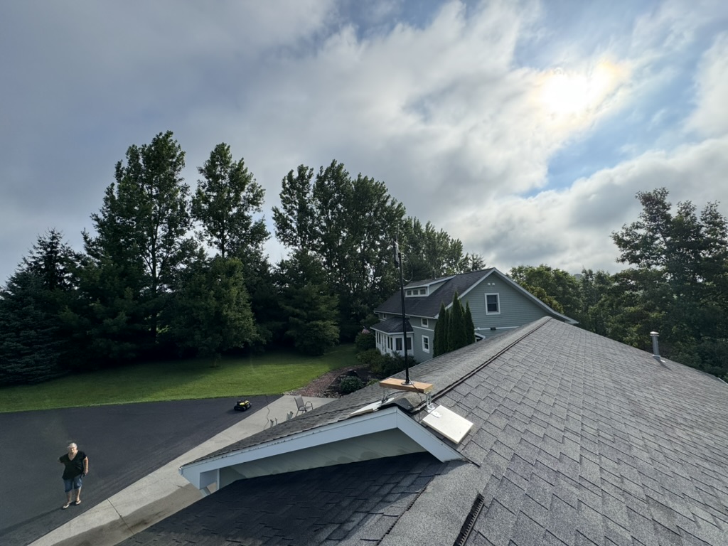

Those all look good. Where is that screenshot from, on the docking station or out in the problem area? What does it look like when you tap details there under RTK on the right? This will be the DC’s view of the satellites. Can you snap a photo of your DC install location as well?
  • HaLow signal kinda on the edge. Could this be switching networks?
  • Update Status showing – what is that? Mine doesn’t show the 100% or “Ready” or that yellow bar. Reboot needed to finish something?
That’s why I asked where it was. But it’s still within range.
The update status is normal if you tap that. Always says 100% unless it’s actively updating.

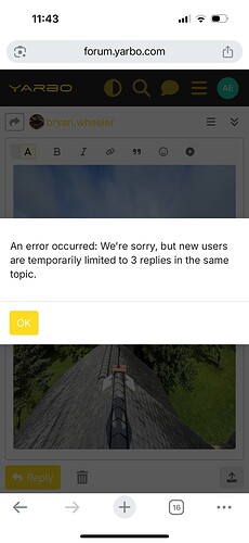

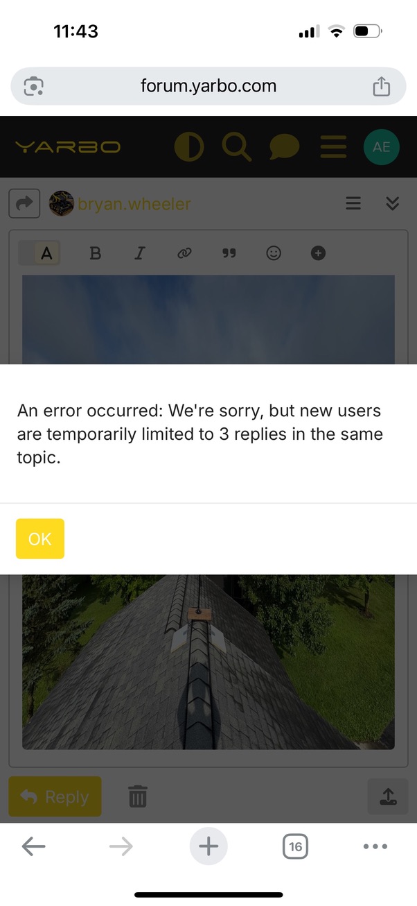

hi - sorry, I would have sent more images but after 3 uploads got this message and wasn’t able to send anymore or an explanation as to why:
I’ve spent the day troubleshooting. I was never able to get sufficient signal to be able to finish installing the data center at the location those screenshots were taken from (garage roof), stayed “poor” the whole time I was trying, at least 30 minutes, so I ended up moving it up on top of my house which is higher than the garage by at least 10 to 15 feet but closer to a line of trees that are extremely tall (probably 100 feet high). the signal waffled between poor and excellent, so I grabbed it during an excellent and temporarily installed it there so I could trial some more mapping with the patrol function (I don’t have the lawnmower pro yet until it ships in august or whatever). It worked a little better GPS-wise, but still a LOT of dead spots on the property. simultaneously, the patrol mapping seems to have a lot of software glitches so between the two problems I am admittedly pretty frustrated. Not ready to give up by a long shot though, I am determined. Hopefully I will get more flexibility with this chat function to facilitate some troubleshooting. I think I will need to take one locale/one gps deadspot at a time to learn from you how to troubleshoot so I can figure out how to troubleshoot on my own for the property. I also am hearing that software updates for navigation under trees are coming soon??? here is pic from the garage roof location (that wasn’t working yesterday or this morning):
