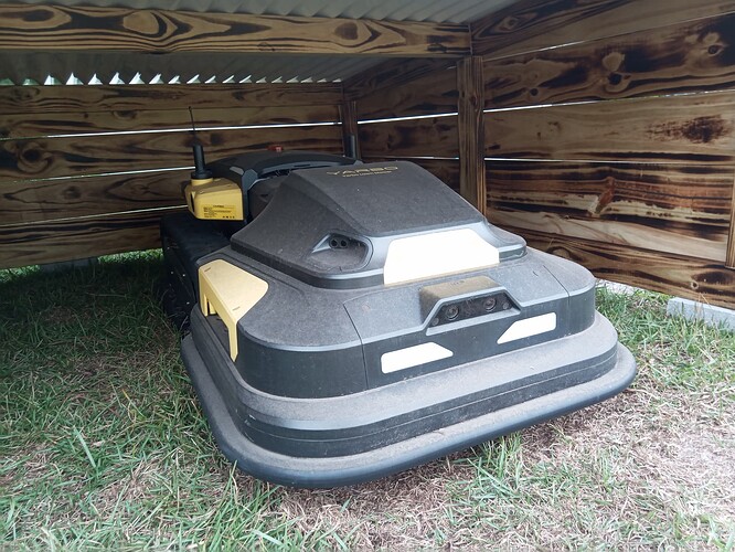

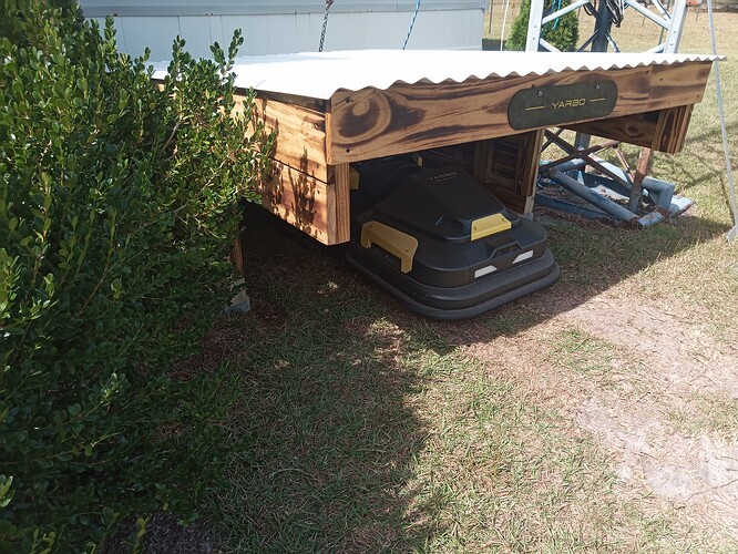

I built a Yog house for Yarbo because day after day I watched my little buddy roasting in the sun and drenched in the rain. IV tried shade cloth with a PVC pipe frame and Yarbo just ripped it to pieces. I decided to go ahead and build something that will hold up to the weather and something yarbo can’t push around. 6’ deep by 5’ wide and 30” high in the front 24” in the rear. it doesn’t seem to interfere with the GPS at all. in the docking settings it has to be set to zero turn so it doesn’t run into the sides of the house. does anyone know if yarbo can be set to turn around further away from the charge pad? if it can, I can push yarbo further under the Yog House. there’s also plenty of room for a box fan for ventilation if necessary.

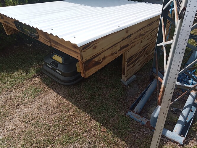

I ended up having to make some adjustments to the yarbo house. I had to cut a 2’x17” notch so yarbo can turn around and still be covered.

That’s really cool. But where is the charging pad? What is the roof material, polycarbonate?

It would be nice if Yarbo added many more options to docking, i.e. module height. As it is mine is able to turn around before docking (barely) but only because the module half sticks out. I could imagine Yarbo taking the whole pathway in reverse to allow for full garages like this.
Agreed. It would solve a lot of problems for people and make so many extremely happy. There are a lot of good reasons to do this. Including not tearing up the spot right in front of the dock where it currently is turning around to dock. Smart turn out in a known open area and back all the way down the path and right onto the dock.

The charging pad is under the yarbo. The roof panels are from Lowe’s. Don’t know what kind of material they are. But it doesn’t seem to interfere with the GPS signal very much.
I guess as long as it’s not metal, it should be fine!
