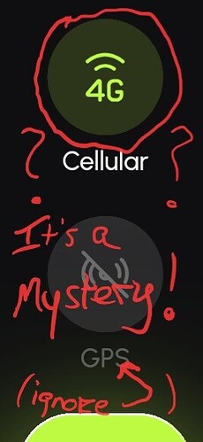

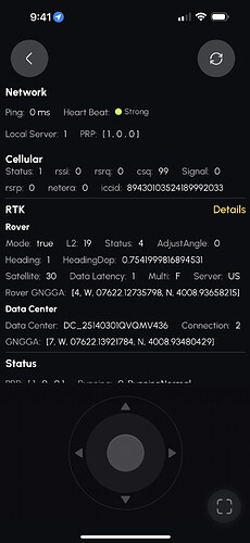

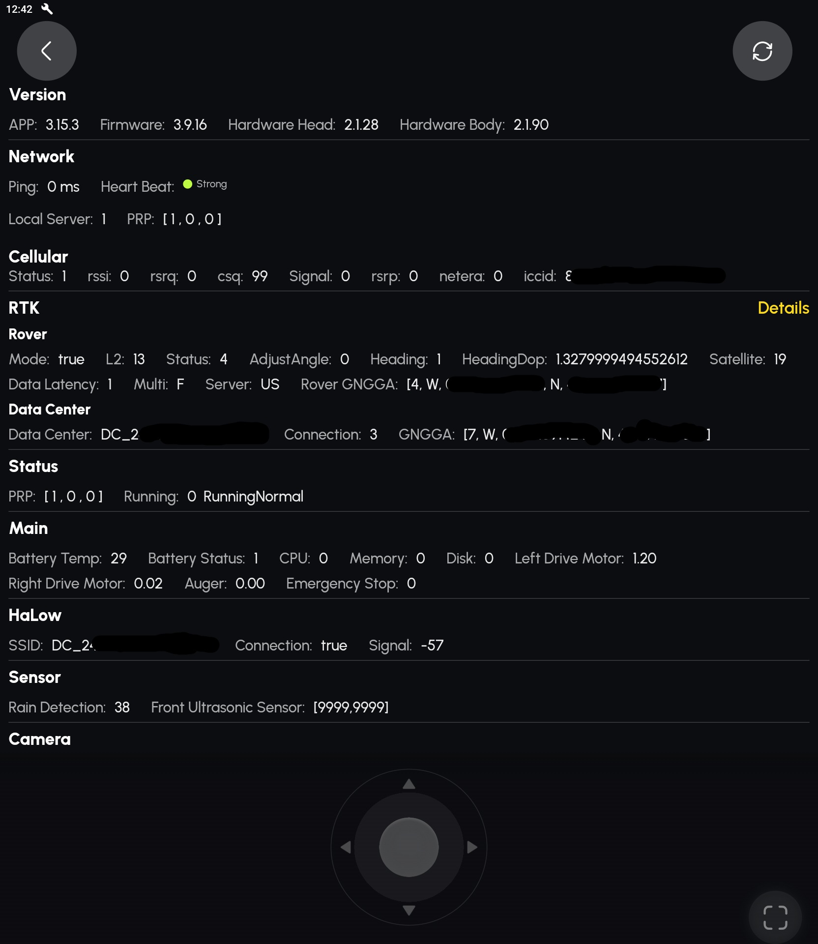

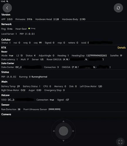

My network icon is showing 4G while the rover’s out mowing. Yet:
  • No numbers are changing under Cellular, all zeroes
  • Data Center Connection 3 (Local HaLow)
  • HaLow Connection true, Signal -41 (or whatever, always > -70)
I’m not sure the network icon always reflects reality. Ignoring for now, may try a hard power cycle of everything after the rover’s done its work.
Anyone else? Is this new (or, rather, more prevalent) with the latest firmware? Or is there something in the diags I didn’t spot? (I’m still learning those.)

That happened to me yesterday, the day after I got the new firmware. I ended up bouncing the DC to fix it.
This has been a recurring issue for the last few firmwares at least. If your cellular data usage doesn’t increase at the end of the day, it is most likely a visual glitch.

Yes your internet being down would explain the 4G and DC connection status mode 3 (local HaLow). By the way, it’s normal for it to flip back and forth periodically between 2 and 3 now, so I just assumed you snapped the screenshot during that flip.

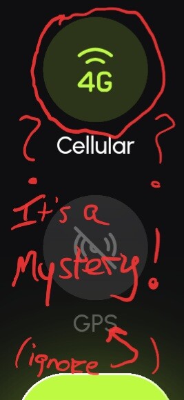

Can someone tell me exactly what that network circle icon represents? I assumed how the rover is talking to the Data Center. But it may be how your phone is talking to the rover. I’m beginning to think it’s an overloaded icon and shows either when it wants.
That icon just like the GPS icon is an enigma of ambiguity. In this instance it is how your rover is connected to the internet so that you can connect to the rover. I see your gps icon is grey. Assuming that is just from not waiting long enough as you should be good to go in local HaLow mode even with the internet to the data center being offline.

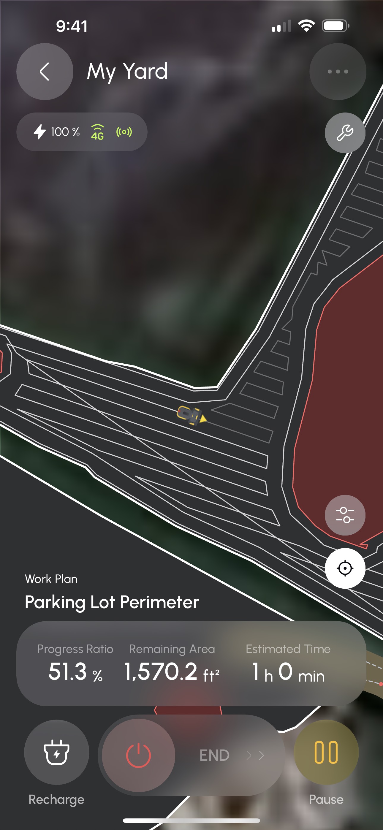

Thanks for your question! The network icon may reflect two scenarios:
  1. When you’re connected to the rover via Bluetooth, the icon will indicate the Bluetooth connection.
  2. In other cases, it shows how the rover is accessing the network—whether through HaLow, Wi-Fi, or 4G.
Hope this helps clarify things! Let us know if you have more questions.

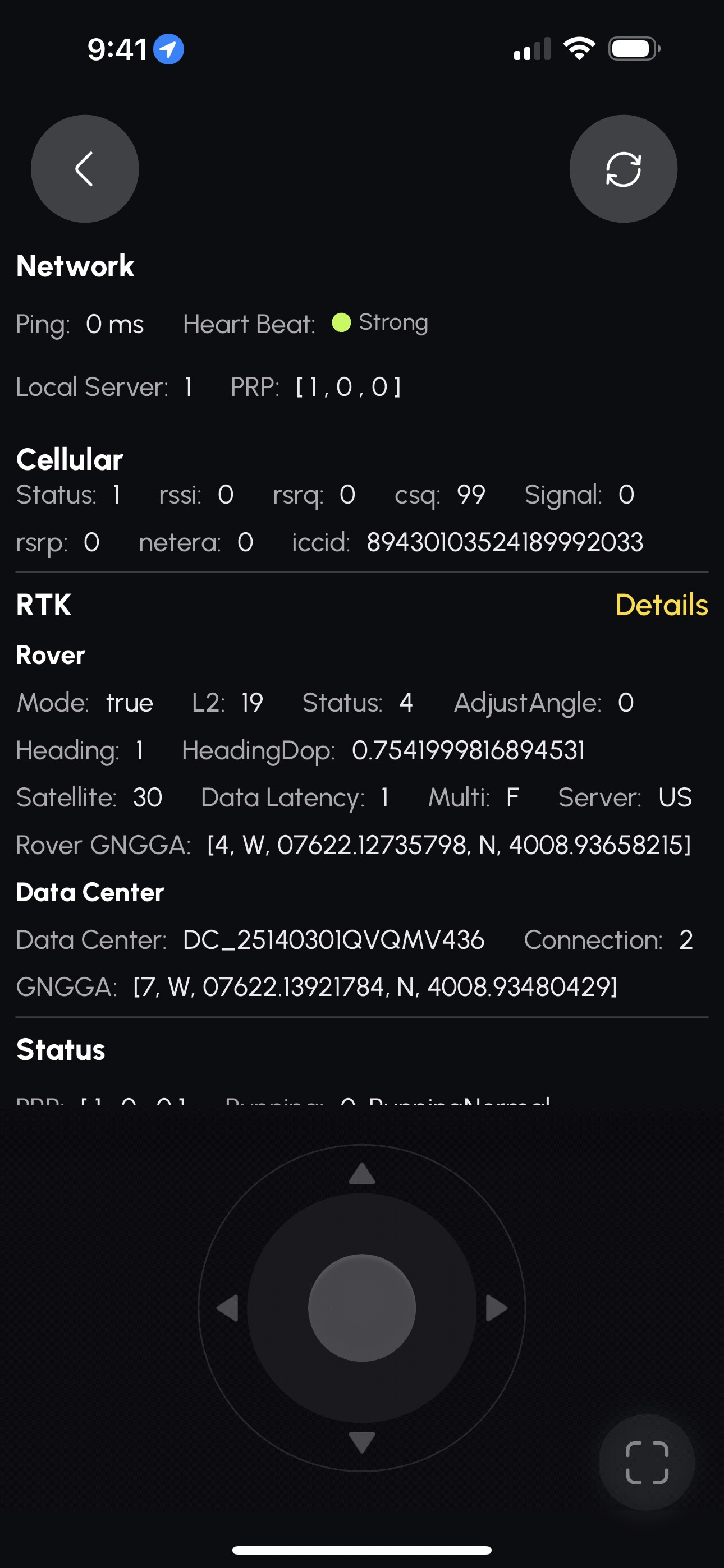

Got the same thing going on now for the 3rd time in a month. Stuck in 4G. Rebooting the DC has cured it both previous times, but I’m not resetting this time. I opened a ticket and Recorded Issue and noted the time. There was no firmware update near any of my incidents. Halo is stuck at -58db. and Connection: False The Cellular diags haven’t indicated any activity. I’m about 100’ away from the DC. Something is causing Halo to crash.
