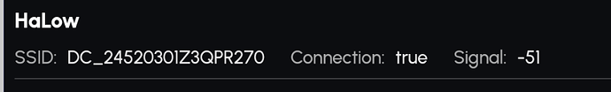

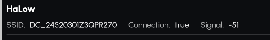

I was having a heck of a time with crappy HALOW signal, only getting about 50 feet of reliable range out of it. The core would flop to cell or wifi and continue.
If you haven’t yet, park your core directly under your DC and check signal.
This is mine, 50 feet away. And it stays that way for good distance.
Directly underneath is -34. A hundred yards out behind some trees and a house, -63. Move behind a metal shed back there, and it’s -72.

Once your core is safe to drive around, play with SmartVision to drive to various spots (directly under the DC, for starters) and see what that signal is. If it’s bad (mine was -74 before I fixed it to -30something), start there. If it’s decent, drive to some trouble points and watch that signal strength. -80ish is the kickover point. Grab a post-it note and make some notes about what and where, see if you can find where HALOW gets sketchy or ends. Although if you go all the way out, you’ll have to get into bluetooth range to get your core back, lol. So probably find where it gets sketchy and skirt it, unless you are walking with it.
