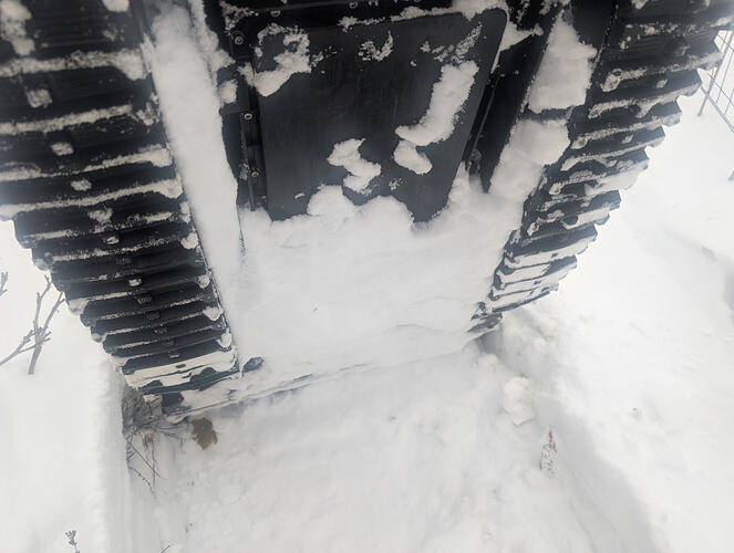

Made a nice imprint of the bottom of Yarbo😅
Yea, I had mine bottom out a couple of times, but it was my fault because I had the auger adjusted too high.

My Yarbo would not start executing the plan or go to recharge for unknown reason even after I performed multiple mock tests before the storm. Last night I tried to put the plow blade tinkering with the screws with my son trying to attach it, it was not fast. Finally trying to use it, but the augur would not move up and down to touch the ground, so it was another failure with the blade.
Was there snow packed under the module preventing it from moving? Did you unplug or connect the module at anytime while the core was powered on? If so that is known to cause problems. A reboot solves most issues afterwards but sometimes support has to reinitialize the module on the backend. Try the reboot and see if the module moves up and down. If not, make sure there’s nothing blocking it from moving and open a ticket for them to check it out.
nothing was under the module preventing it from moving down. There was about 2 inches space because the module was up before when I was doing a mock test. I did disconnect the module once and reconnected again but still did not solve the issue. I also unplugged the battery and connected again still did not solve the issue. My issue right now is to get the snow blower executing the plan or go back to dock station, which stopped for unknown reason. I will relocate the docking station and see if this may resolve the issue according to support suggestions. It was frustrating not to be able to use the snow blower the first storm we had after all the preparation I planned.
If you tell it to go recharge it doesn’t give an error of any kind?
It does not. It would start the augur and rotate 90 or 180 degrees and not move, but the augur is on. No error message
That’s frustrating. It does say it is adjusting the module. Can you use the app to move the module up and down?
Is the module blocked from raising and lowering by ice and snow? Usually under the module or between the module and core?
It does not allow me to adjust the module up or down. Nothing is blocking the module, no ice or snow. Yarbo was sitting in the garage clean when I moved it out to snow blow. Usually, I do that and send it to the docking station to start the plan during the summer when I used the mower. everything was fine and it worked. Notice one picture, I also tried to use the blade, but no success because it would not allow me to lower the module. It was two failures in one day.
Maybe pull the battery for a couple minutes and reconnect it. Watch it during the startup process as it tries to move the module up and down. unfortunately you may need to open a ticket if it doesn’t move the module.
