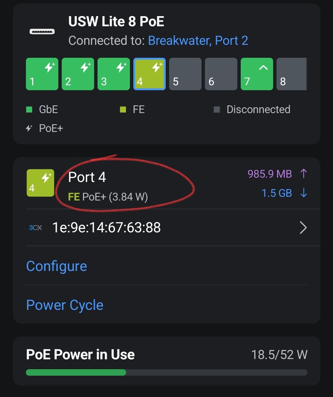

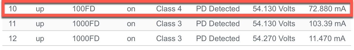

Here’s mine. Port 10 in the screen capture. Not much power draw at all. But a little interesting to see that it’s only 100bt.
