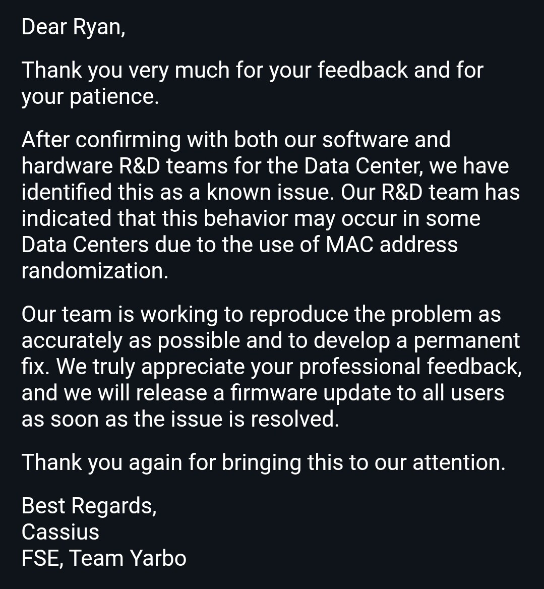

Ticket #108517 submitted
Confirmed know issue.
