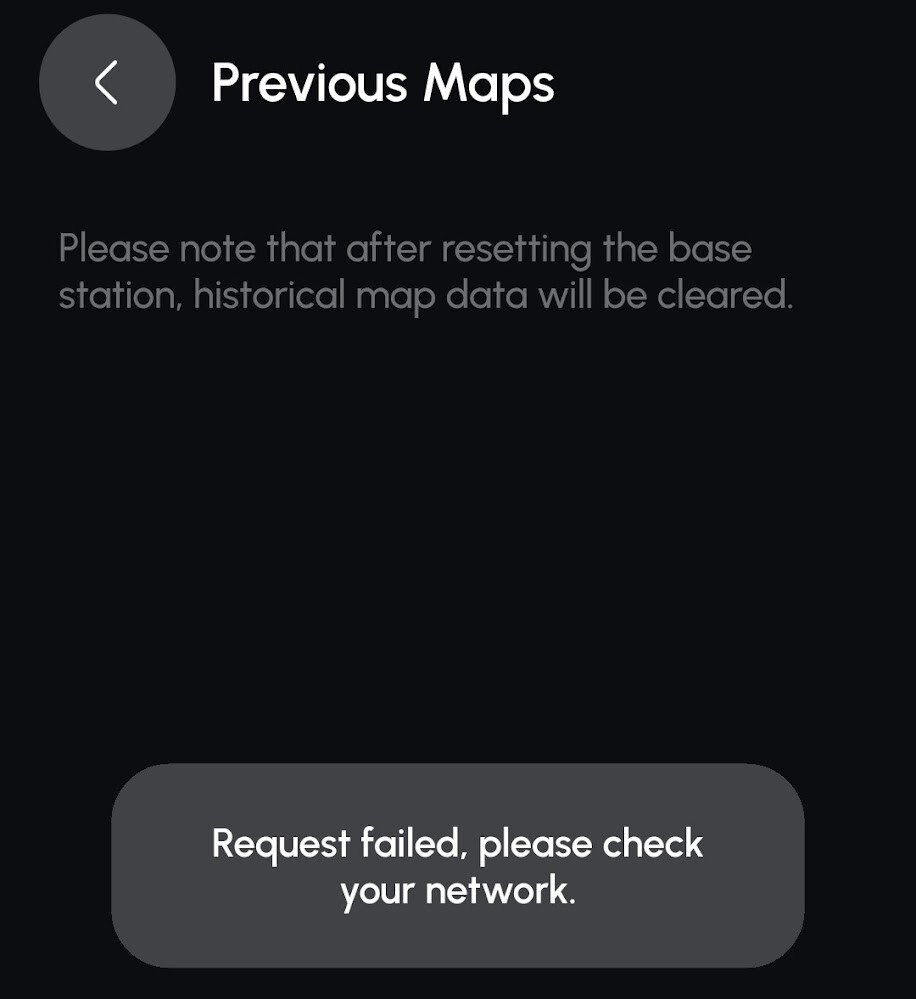

Can you point me to some background on your “Request failed, please check your network”?

@ken.w.gregory - Sure, quick bullets for you –
  • Mostly going to Previous Maps, although it sometimes works (and just did on my Android – twice in a row – three times! – wow! – I did delete some stuff of my map, so who knows)
  • Previous Maps seemed to always work on Bluestacks, not so much my Android phone (which is from, like, this year, Bryan, not 1927)
  • Seen trying to change Settings on an Area, at which point it messes up what’s in memory, so any changes to that Area you may confirm after that are not going to be right. This is a bad bug IMO, as it’s not saving what the user set, and there’s no error message.
  • Map calculation slowed, and I was always afraid it would fail, and, in fact, hitting Start on a Work Plan showed the swirly but didn’t do anything a few times, but there was no message. As you can hit the start button again and usually have it go, it “works enough” for me.
  • Seen when going to Diagnostics, although you can see the diagnostics changing behind the error, so it does go there
Probably other places. You get the idea.
Bottom line:
…when trying to do various activities around the App, Yarbo stating it’s my busy map (which is crazy AND insane) and they found at least one bugfix for it at least and updated the servers with it. I guess my map is a good test case - if they fix a bug for my stupidity, it’ll help everyone.
