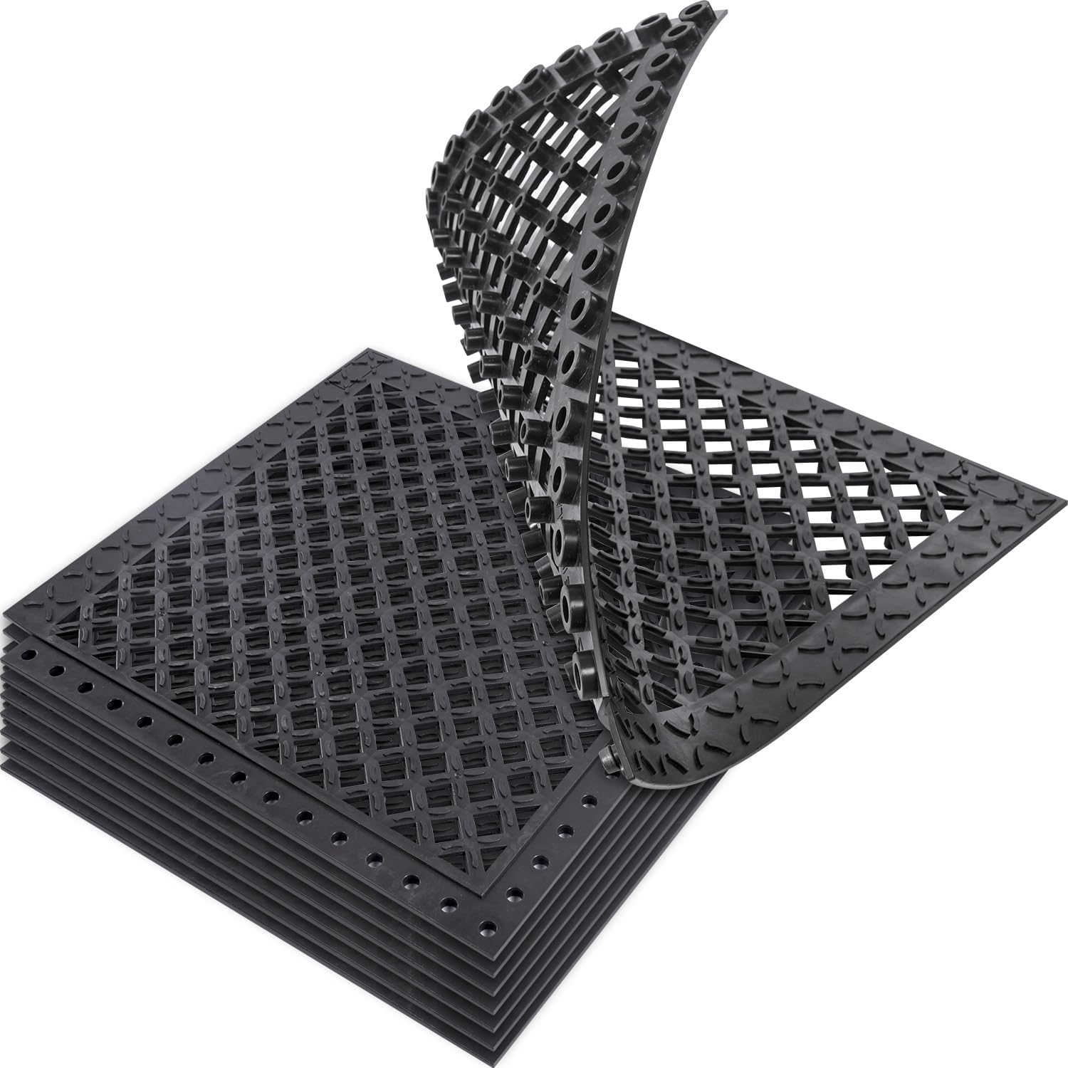

You can pick them up at Rural King, last one I ordered from amazon.

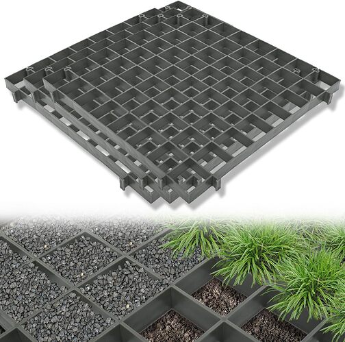

Im using this type of plastic mats. I have the honeycomb mesh. Took a small concrete vibrator from a friend and used the lowest power mode on it to get the mat neatly to the ground. Worked perfectly. I have those in front of the charging station and on one pathway what I can’t change.
Highly recommended way to protect your lawn from Yarbo. Just make sure you don’t press the mat all the way inside the lawn. I left it about 5mm above. That way the grass under it is protected from the tracks Yarbo has. Most likely 1mm would also be enough. I have noticed that Yarbo has pushed the mats in front of the charging station all the way to the ground. Or maybe the tracks have moved some dirt and old grass on top of it and now everything looks neat
