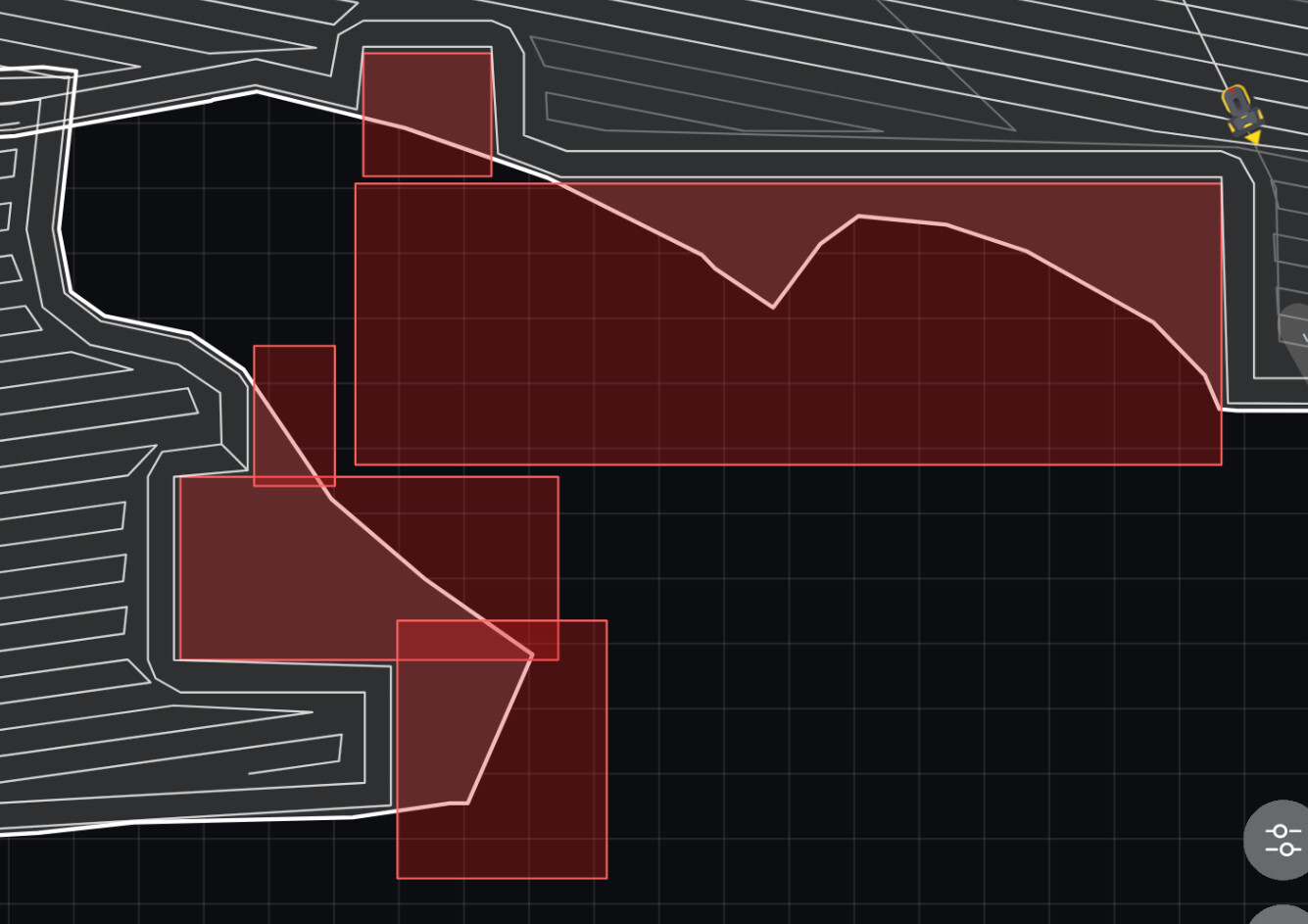

24 - Use a dead-end to poke the M1 under shrubs and bushes without putting the antennas in there. Start a decent distance away.

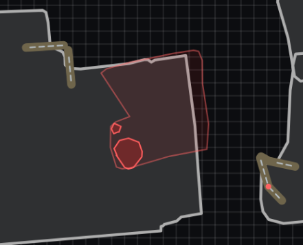

I drew two small NGZ… just need to cut the small strip of lawn around it once in a while. But I made the NGZ small enough that it is barely noticeable… I do some variations of what has been said before. I first draw the NGZ. Then I put a smaller NGZ template on top of it and delete the one I drew. It makes the mordre tighter. But this work only with squares/rectangles or rounds…

Neighbor has some shrubs and brush that, if we trim them to be safe for the antennas to pass under, it’d be naked. But there is a nice gap between them and the ground. It just isn’t as tall as the antennas.
Since the Yarbo is so long, it can drive straight in and easily wedge the M1 in there, leaving the antennas just out of reach of certain doom.
The map above shows four dead-ends managing a corner that another neighbor (next door to the yarbo area) simply never mows, because I guess he likes having skin on his arms or some lame excuse. I have Yarbo peek it’s head in there to take care of it for him. The idea also works with things like parked RVs and snowmobile trailers that have grass happily growing under them (at least along edges), but are too low for Yarbo’s antennas to fit under.

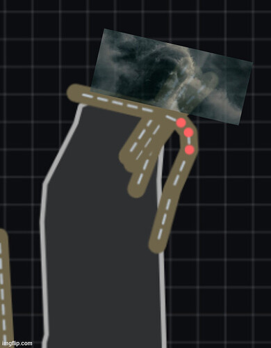

Good idea. And what is this other deadend that curves that seems to be out of area?
I have some spots made for that little trick.
And the red dots in the curve?
