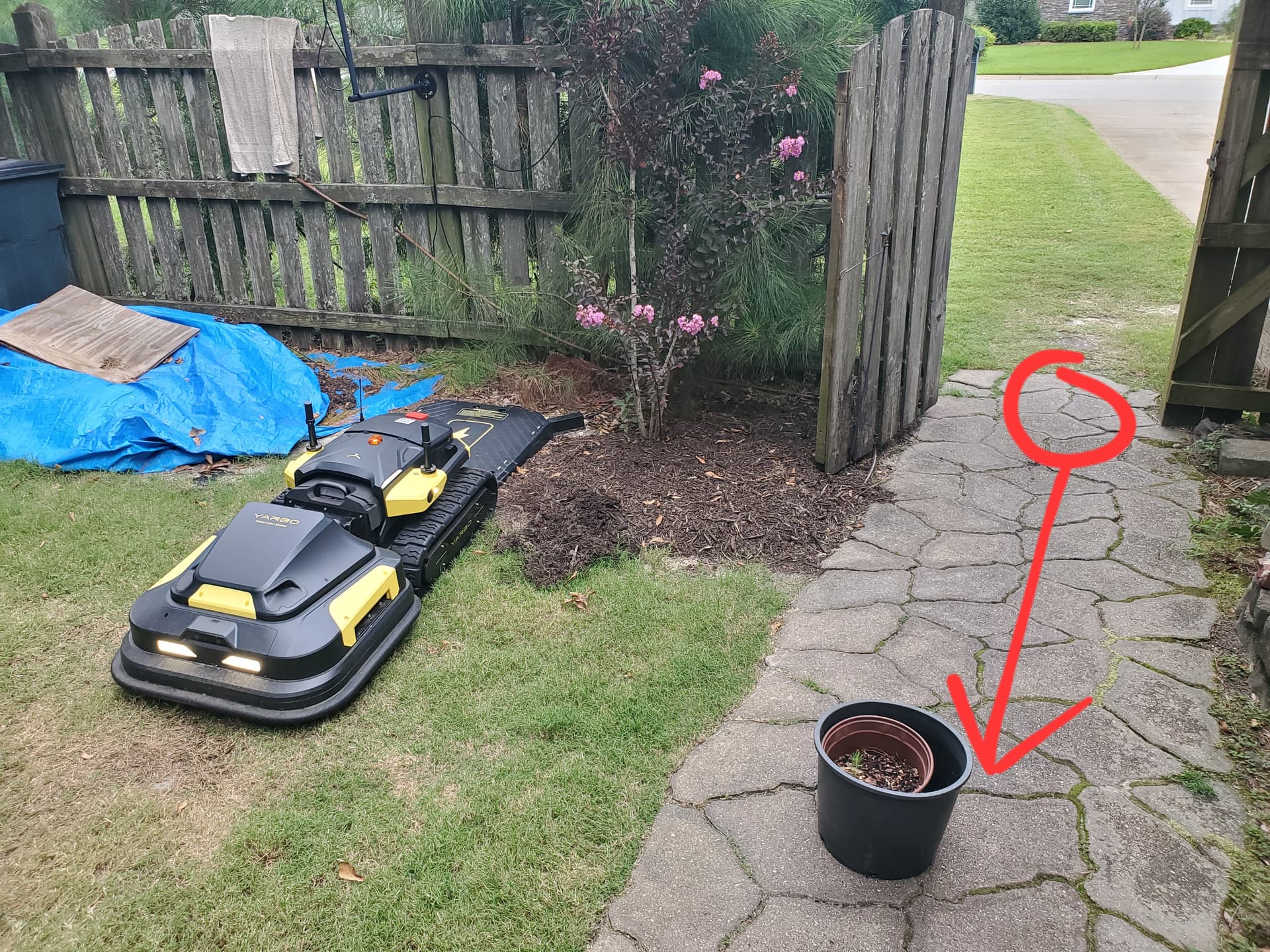

I have a pathway that starts with a turn but yarbo sees the bush that encroaches the edge and gives up completely with obstacle avoidance on. This path was created recently.
I have another path that is from months ago that seems not to care about repetitive bumps into a 3 gallon pot as it pushed it along 6 ft before the path turned away. Even got a Collison notification but kept trucking.
Scared of a bush but will push into an object on the path… I had hoped it would quit when it hit the pot so it would not worsen my yarbo spot in front of the charger.

You could place a no vision zone where the yarbo is when it sees the bush. Where is the pot in relation to Yarbo? Is it green or blending in with something else?
Base was not plugged(yarbo lost to the inflatable toddler pool/bubble machine …) so it made a mess of the mulch.
I’ll throw a brick in the path to double check safety tonight. The pot had decent weight but the soil in the outer pot was below where the bumper would press.
I’m thinking the pot just didn’t have enough mass to trigger the bumper or it hit on the corners.
