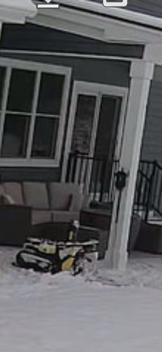

1st major snowfall - big fail
Your data center needs to be up above your roofline or out in the open with a 120° cone to the sky. Move your data center and you will see your problems disappear. If you want temporarily drag it out into your grass that you won’t need snowblow and install it there with the ground spikes. Then move it up on your roof or to another permanent location in the spring.

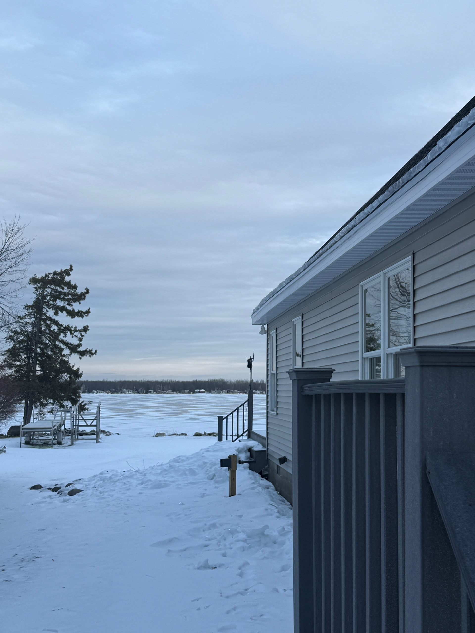

This is how my set-up looks. This works for me. For now. For the winter. Which I choose to have a winter and a summer DS location. I will probably move my DC again as well and remap. Mine is 10 ft from the house so I’ll probably find a better more permanent spot so it isn’t on the corner of the deck. Hahaha
