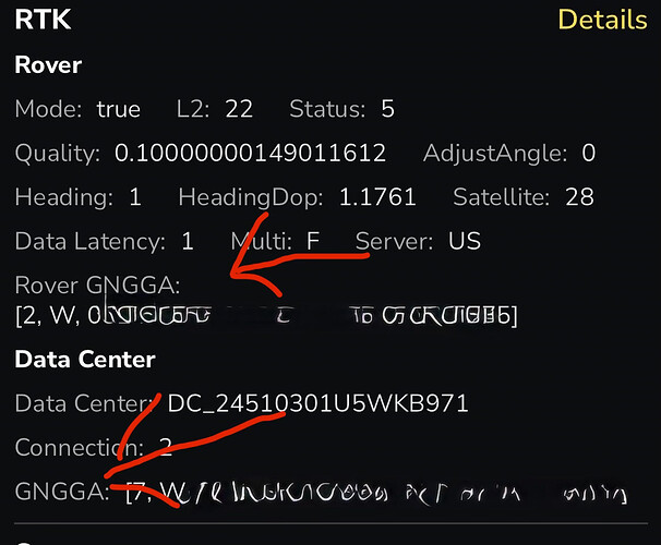

Can you post some screenshots of your diagnostics screen (RTK, Status, Data Center) where it is having an issue? Did you adjust the PPVS settings at all to get it to map? How does your DC CNR values look?
Your GNGGA is your lat/long. You may want to obfuscate that part.

Thank you, but I have no clue what that means. Could you explain GNGGA and “obuscate’“ that part to a Yarbo brand new owner…? Thank you!
On the diagnostics page, you’l’ see two GNGGA entries. One is marked Rover GNGGA and the other on is simple marked GNGGA.
Those entries contain the Latitude and Longitude of the Rover and the Data Center. Ie. your location. Some people don’t care to share their location but others would prefer not to.
If you dont wish to make your position know obfuscate or remove those two entries.
Here is where they are found on the diagnostics page:

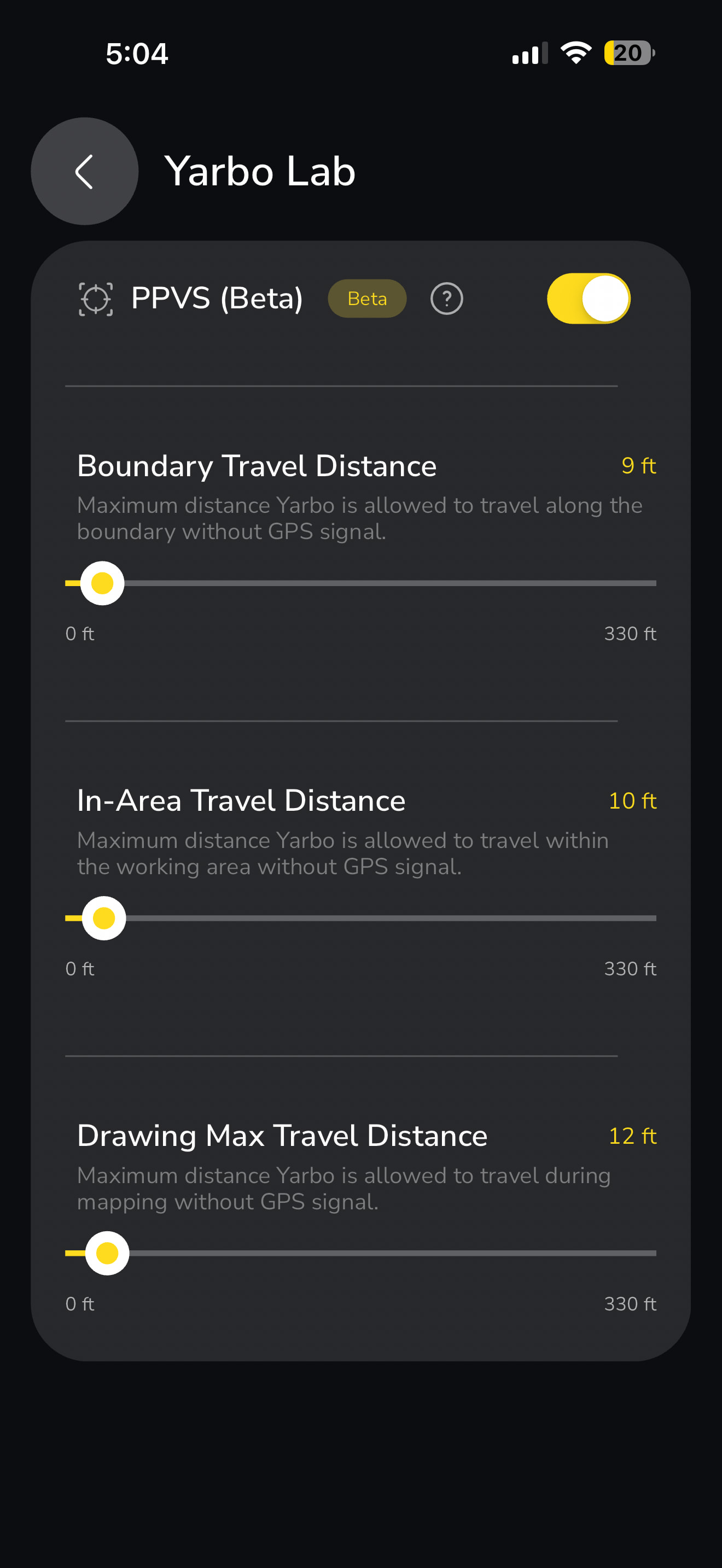

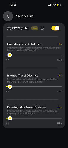

Thanks everyone for the help above. Attached are the requested diagnostic screenshots, I’ve attached a screenshot showing me trying to completely re-map the driveway from scratch (Yarbo Lab / VPS setting also attached).

I have the VPS settings a bit conservative (under 10 feet), because the first time I tried to get the map to work with higher settings (20 + feet) that was when Yarbo drove off the driveway and almost into the creek.

And here’s the lab VPS settings that I’m on:
Can you do another 10ft adjustment on the PPVS setting to get you to your next shot at a signal? So you aren’t having to ram it up to 120ft? I know sometimes I literally need another 2ft sometimes for a good ping.
I think he said he tried it at 20 ft and it nearly went into the creek. I ran mine up A LOT at one corner of the house. It succeeded but you can bet your last dollar I’m watching the snow blower on that corner of the house. Fortunately there is a good view from the couch. :wink:
I suggest you temporarily bump up the PPVS settings a bit so you can complete initial mapping, then lower the settings and do some testing to see how Yarbo behaves on the driveway.
To me, I think it’s best to remain conservative with PPVS for now.
My bad I must have misread that. That stinks too because it didn’t occur to me that mapping without “green GPS” you could inflict core drift. Certainly logical.
Smart to dial it back after mapping. Then if it stalls…
We try again.
Maybe some guard rails (no go zones) along the creek? But I guess if it doesn’t know where it is, it won’t know where the no go zones are either.
Maybe vary the time of day you make the attempt?
To complete the mapping, you should only need to adjust the bottom slider.
If it was me, I’d only give it the bare minimum required to complete the mapping. Then to a bunch of testing to gain confidence they it won’t veer off course and end up somewhere it shouldn’t be.
