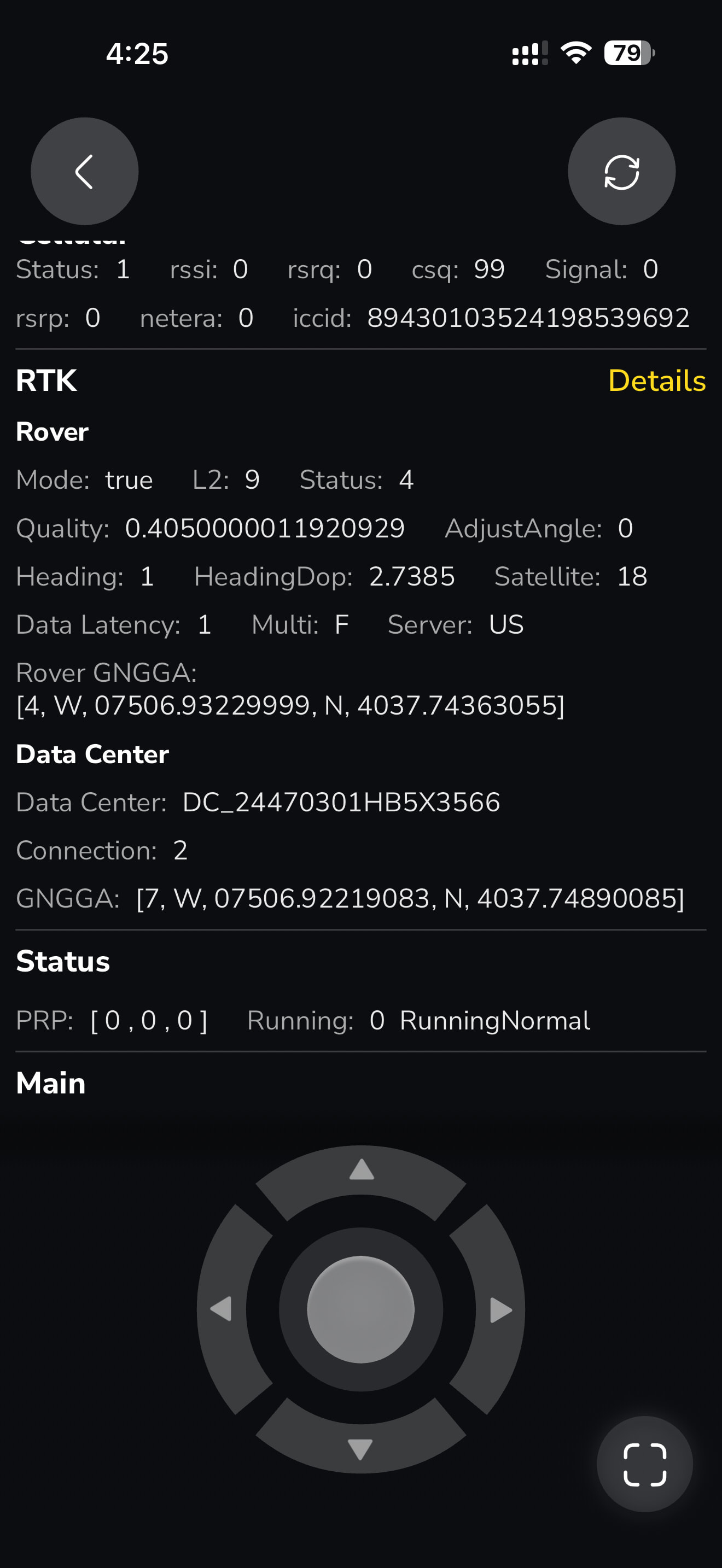

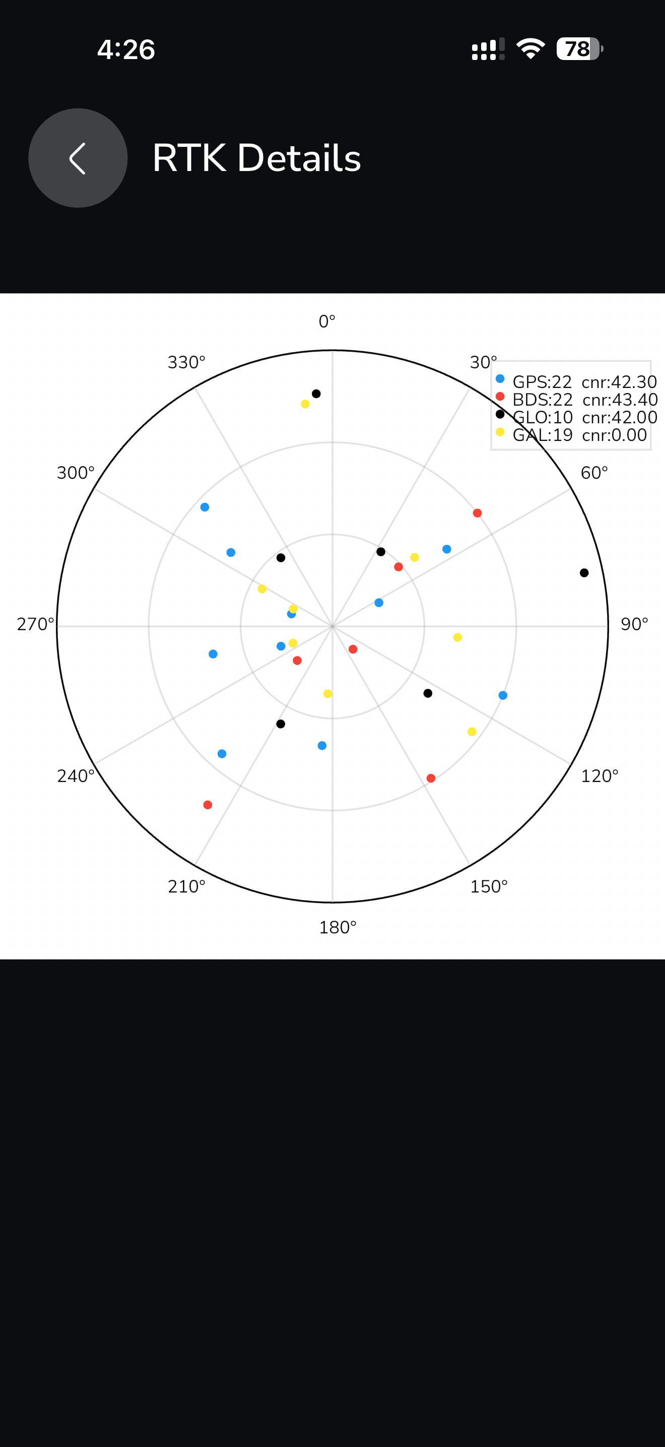

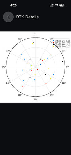

So, I’ve listened to some of the suggestions here and moved the DC to an area where I have a stable strong signal. I have zero tree cover so I have a clear view of the sky in all directions. I remapped my driveway and zero hiccups signal wise. Everything was great. App showed strong signal connection between Yarbo and DC. I placed Yarbo on charging dock once I was completed mapping and now I’m getting a GPS disconnected error. Wtf? The dock is literally 30 feet from the DC and all was well until the unit went on the docking station. Any one have any thoughts? Screenshots below of the diagnostics

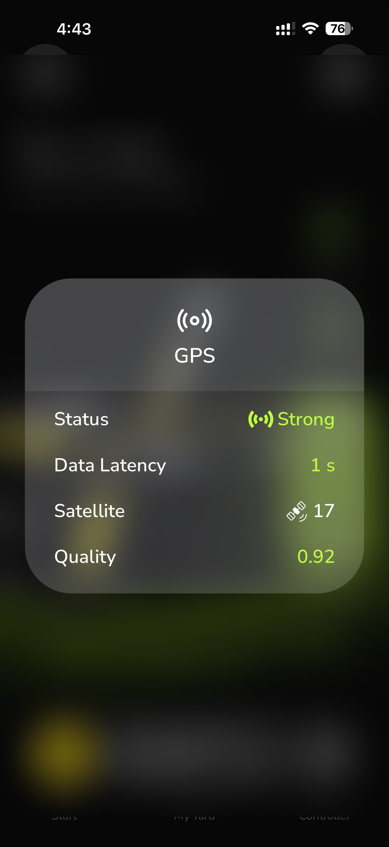

Now it’s back to strong on the charging dock. I don’t get it?
It looks like your dock is obstructed. The rover has GPS antennas that need a clear view of the sky on the dock too. In your diagnostic, your GPS quality was lower than 0.5 and HDOP was over 2. That’s why it was “disconnected”. Quality can bounce around a lot. This is normal. When the core is idle for a while, it can take a while to wake up the GPS and find its location when the dock is obstructed. Try relocating your dock or just leave the app open for 5-10 mins before starting your plan. As long as your RTK status is 4, you should in theory be able to start your work plan. Your DC signal looks fantastic BTW.
Thanks. That makes sense and is in line with exactly what happened. It took about 10 minutes for the GPS signal to indicate strong. I may look at alternatives for placement of the docking station. Appreciate the help from everyone and I’m crossing my fingers that everything works as intended during this weekends projected snowfall.
