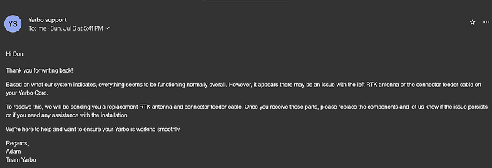

Wow, didn’t you just replace these parts on your own?
Just the HaLow cable. The RTK antenna both on the same side. Yes Sir. Well I guess I should have asked them. My left side is my drivers side. US. :wink: But you also had me swap the antennas, and they had me swap them again. The left side wasn’t damaged. But yes still right side for the replacement parts from our buddy. The ones they’re sending haven’t arrived yet. :wink:
Their left is as you face the rear of the core. The left antenna is the primary. The right is secondary and is what displays the number of L2 satellites. Swapping the two can help determine if there is an RTK antenna issue or a cable issue (or both).
Alan will get you hooked up I’m sure (if you want to go that route). At least when Yarbo’s arrive you’ll have some spares.
That was what I was thinking of doing. You read my mind. I can’t just sit still on this waiting thing. I’ve wasted 2 months now hoping for this delay thing will stop. I’ll hit him up with an order tonight. He’s on-time 100%. Very happy with delivery, shipping, he replied to me before sending. Super guy. I was hoping our left was the same :wink: I remember reading The left antenna is the primary. The right is secondary and is what displays the number of L2 satellites.
I’m really sorry to hear about the trouble you’ve been experiencing. Your support ticket has now been escalated to our technical experts for further investigation. We truly understand how frustrating this must be, and we’ll do our best to resolve the issue for you as soon as possible.
Thank you for your patience and understanding.
