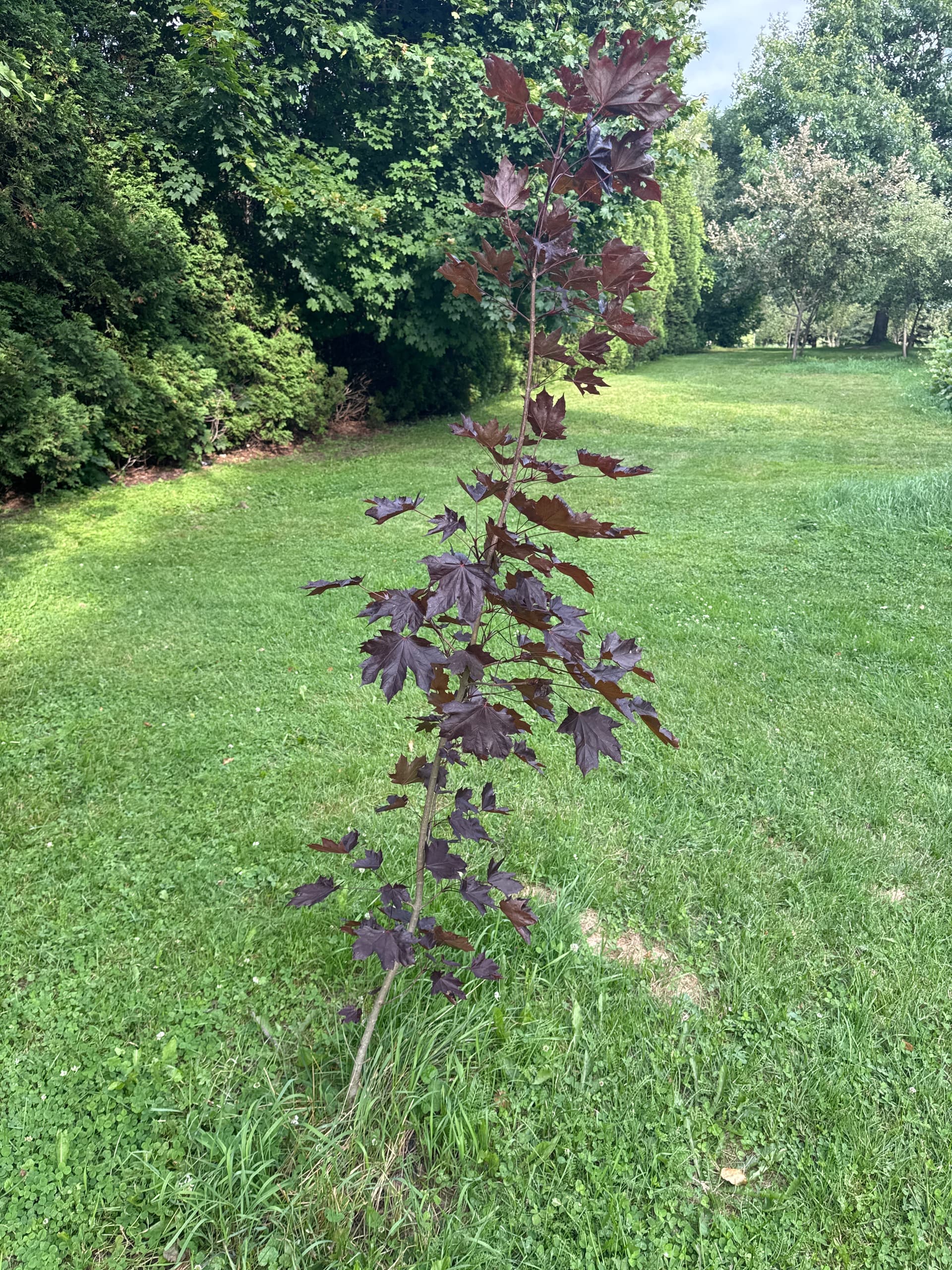

It has been said that smaller trees will not be seen by vision.
Did you leave no go zone around the trees less that 2 inches in diameter?
It sees this one:
NICE! That is definitely less that 2 inches.
But it may be because the leaves are going quite low… this is my only tree below 2 inches.
I find the navigation around the trees quite good in fact. It is not as tight as I could do with a mower, but mowing regularly around that many trees is nearly impossible. Now it looks clean and I can do some edge cuts around the trees when it becomes too obvious. Had to do it anyway with a mower so no difference.
