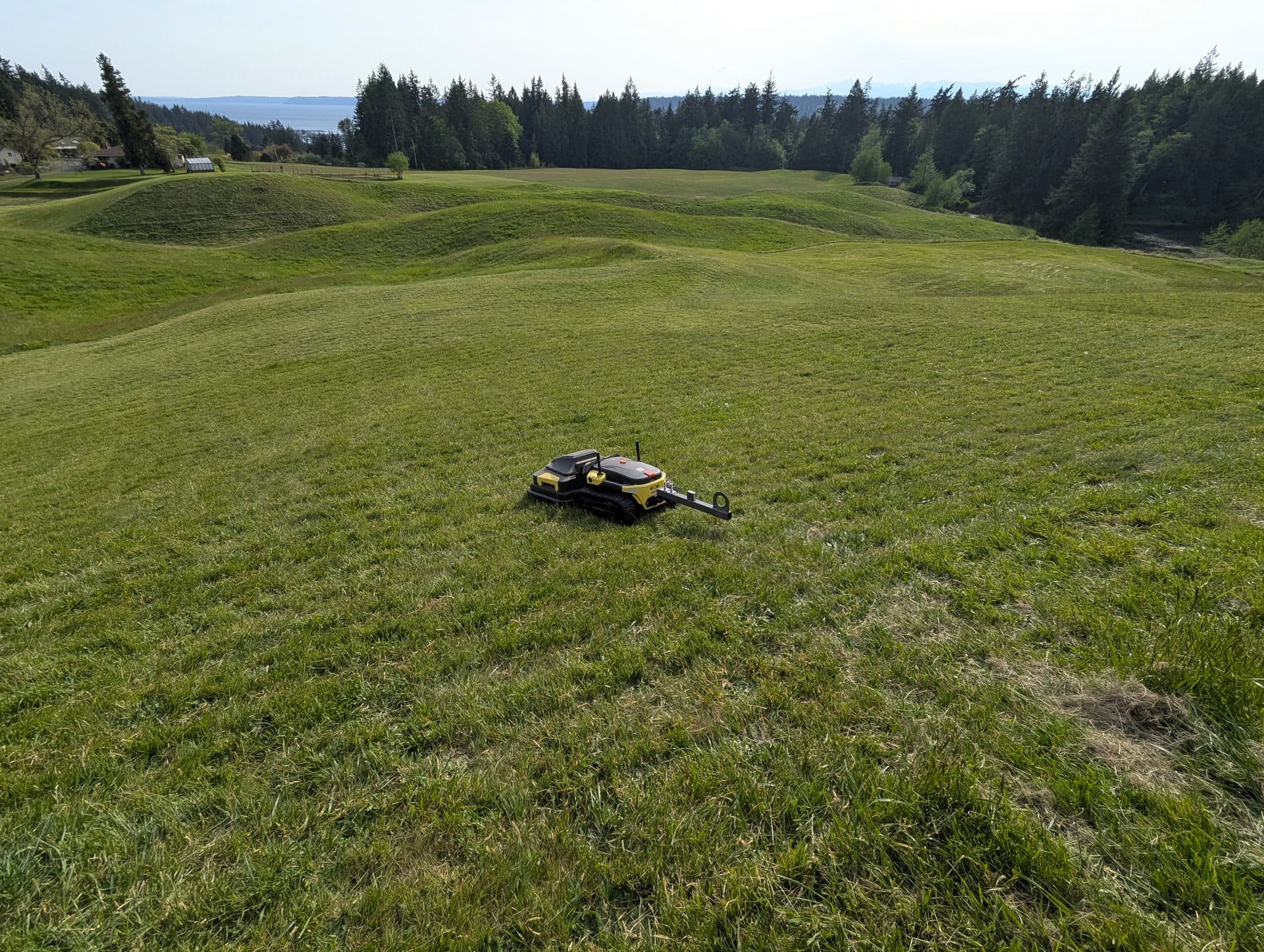

Automated Slope Optimization and Triggers
Automate slope recognition so automated setting optimization occurs instead of making a slope a work area specifically.
Terrain is complex. Mapping a hill as a work area vs adjacent flat areas is cumbersome and not as easily done as stated.
Yarbo has settings for tilt detection. So Yarbo must have sensors to detect and measure slope.
Yarbo module clearance like low/medium/high with m1 or height with S1 are all software controlled not via a hardware lever a user manually adjusts.
Same for speed. Software controlled.
So if I have a work area that contains slopes and flats and valleys etc Yarbo should use its sensors to trigger automated changes based on degree of slope points. Yarbo detects a slope then it should optimize speed, module clearance, etc while that trigger is active to give it the best chance for success. Then when it gets off the slope doing the rest of the map the same sensor says I’m not on a slope anymore back to the user configured area settings automatically.
Making work areas for each terrain condition is not practical especially if more work areas will be needed in the future by module. Right now I have 52,000 sq ft of work areas shared across s1/m1/b1. I kept it to 8 areas. If it goes to by module that is 24 work areas to manage. If I break out more work plans within those based on terrain instead of perimeter bounds then that could easily jump to 72+ work areas.
